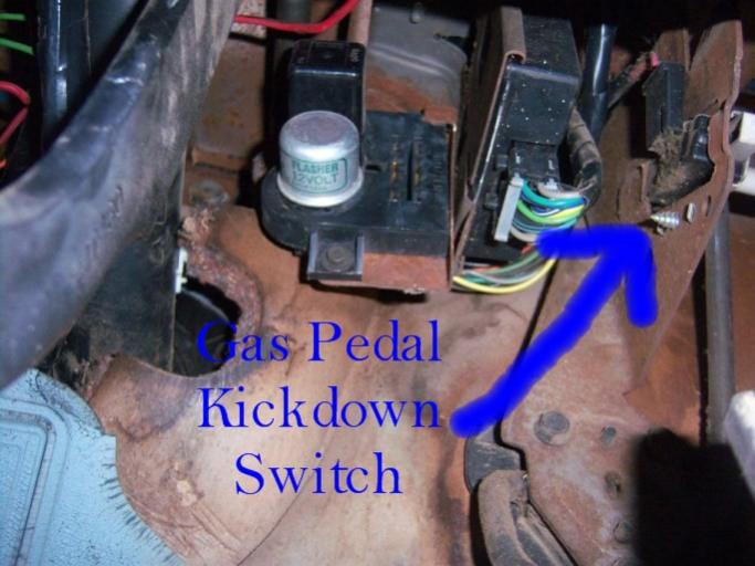

I don't think you read my post correctly, I know all about the manual valve body stuff, I was wondering about adding the kickdown feature. My truck doesn't have the kickdown harness, is there a place I can get one new one and the switch?
Ohhhh OK. There are some places that have it aftermarket. I think your current gas pedal bracket will support the switch, and there isn't much to the harness. If your pedal doesn't support the switch, then just get a Th400 pedal bracket from a PAP. Pretty much, 1 wire from the switch to the spade on the outside of the case. You could probably make your own, with a 5ft - 6ft length of wire and 2 spades that can be solderless connectors since it's not a vital critical component.

Yea I have the bracket in your pic just not the switch or harness. I would realy like the harness for the oem style plugs instead of a home made one. I guess I could find it through summit.

Get a switch, and run a single wire. That easy. I think you get ing power to the switch from the fuse box, then one wire goes to the solenoid spade on the trans. EZ PZ !!! I'd give you a switch offf the burnt truck but I have a feeling it's burnt up. The firewall got way to hot. The pedal bracket is probably good though.

I finally got under the dash and took a few photos of the th400 kickdown harness. It's going to be a little different than later models, but mostly just wire color I think.
All it is, is two wires taped together... The Brwn/Wht wire goes to a fused accessory port on the block and the orange wire goes to the transmission. If you don't care about the clips on the end then we can make you one easy enough. If you want a more authentic looking one I'm sure we can hack one together from misc parts acquired from the junk yard.

Jep, That's all there is to it.
