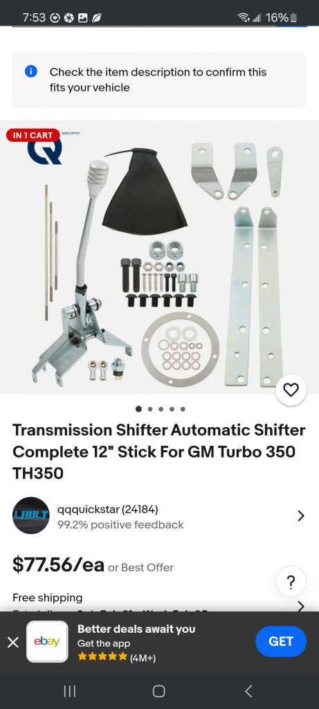

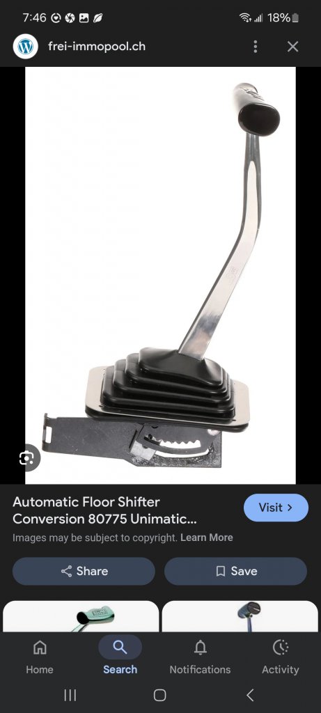

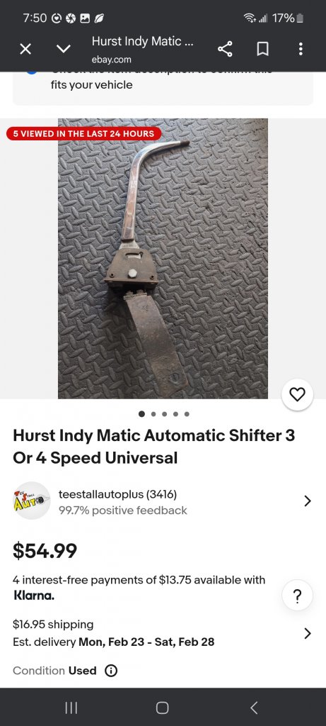

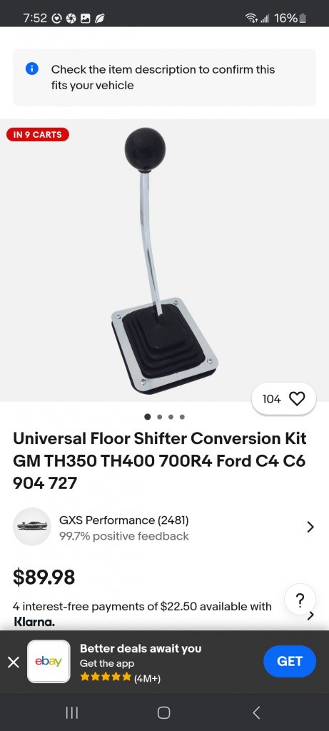

You will also lose your low 1st gear. If you always used 2nd it won't mean anything to you,but if you used 1st much you may miss it. Your crossmember should work,may need a different mount,may need a drive shaft,there are 3 different lengths of 400s so you'll need to check the length of the transmission you have vs,the length of what you are installing. You are going to have to figure out how you are going to shift it and how you are going to kick it down,but that's easy. Personally I'd use a shifter like a Hurst Indymatic,B&M unimatic,etc run a 4 speed shift boot and hold my clutch pedal up with a spring. The truck would look right,cheaper and easier than swapping pedals and columns .

When I swapped one, I had to have the forward portion of the driveshaft lengthened, iirc. I used the same crossmember, but I don't remember if it used the same holes, a different set of holes or if I had to drill holes. The reason I don't remember is because it was no big deal at all and it's been many years. I went with a B&M Unimatic shifter for the simplicity... no swapping steering columns or anything.
