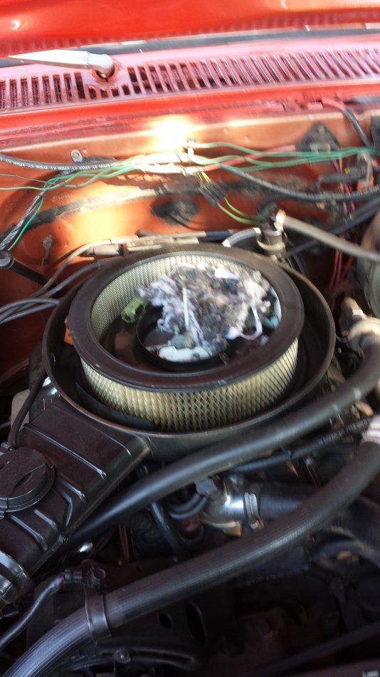

My small block was having trouble with the stock carb. A shop I was having some other work done at suggested I switch to Quick Fuel carb. Got it back and it ran better but would die at stop lights a lot. Took it in for an adjustment and it seemed to be better.
Then every once in a while it would start sputtering, wouldn't idle, wouldn't restart easily. It was driving me crazy because most of the time it ran really well. I started looking and could not find a fuel filter anywhere on the truck. I installed an in line and mine has run fine since.
Here was what started my stock carb problems I believe.
