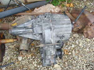

I really couldn't tell you. There should be a metal tag on it with the model number "NP208" on it. If you google some pics of 205s 203s and 208s you can see they have distinct differences. The 208 has an aluminum case and lots of "ribs" or webbing to reinforce the casing...
