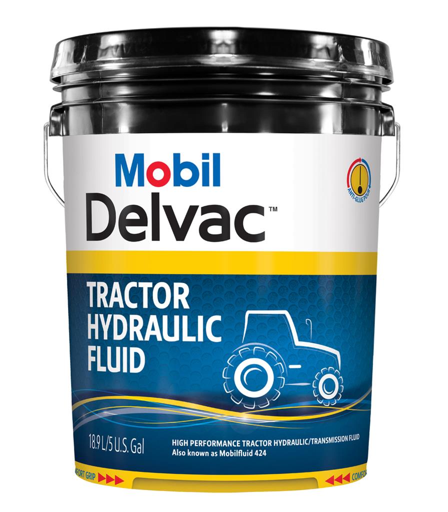

Crap I'm the weird one.
I use Mobil Delvac tractor fluid with a splash of type F for taste. I mean color so I can see it on the stick.
Powerglide race trans.
