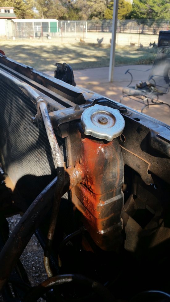

I had a similar problem recently. My transmission cooler inside the radiator began leaking trans fluid into the cooling system. It let go all at once (in one day) and I lost enough fluid that the trans started slipping. It was less than a year since an expensive rebuild on the trans also. I pulled to trans dipstick and don't see any water/anti-freeze but the fluid has a burnt smell.
Worst part was that I had a new radiator in my shop waiting to be installed.
