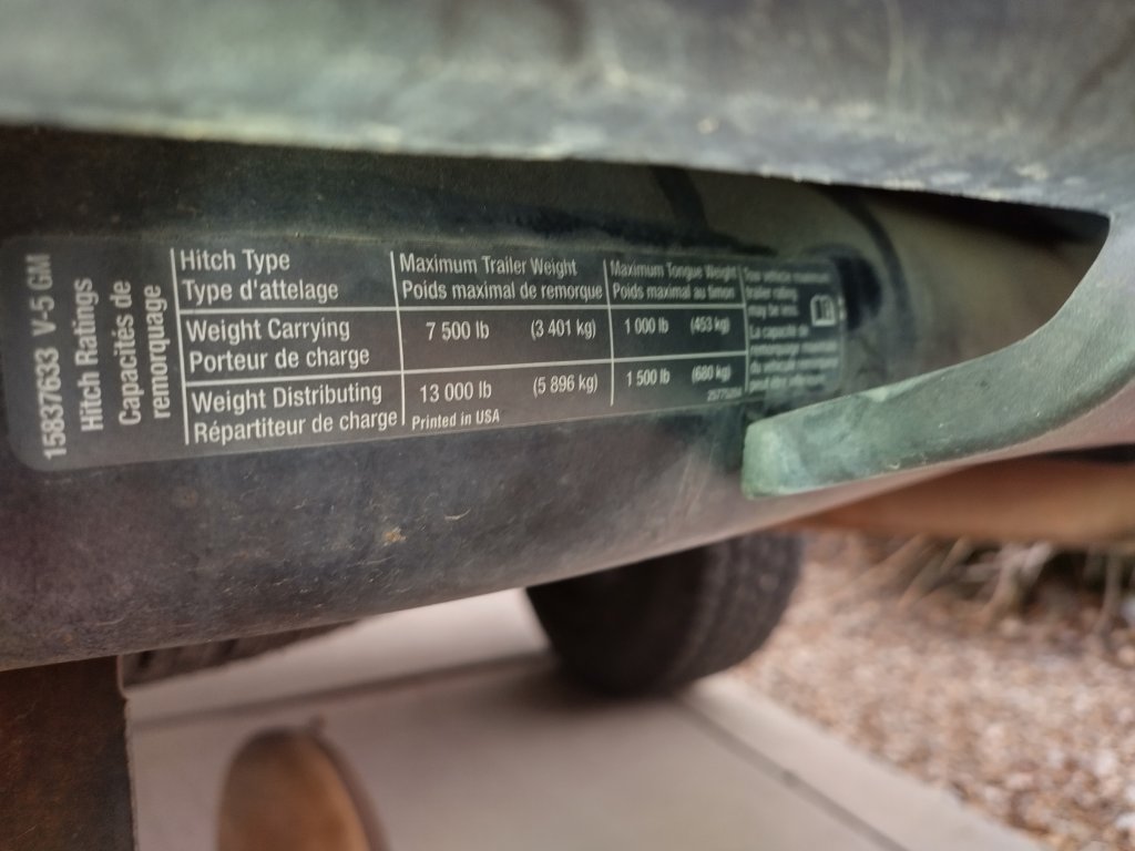

He posted a shot of his hitch that is only rated for a 7500lb trailer weight without weight distribution.

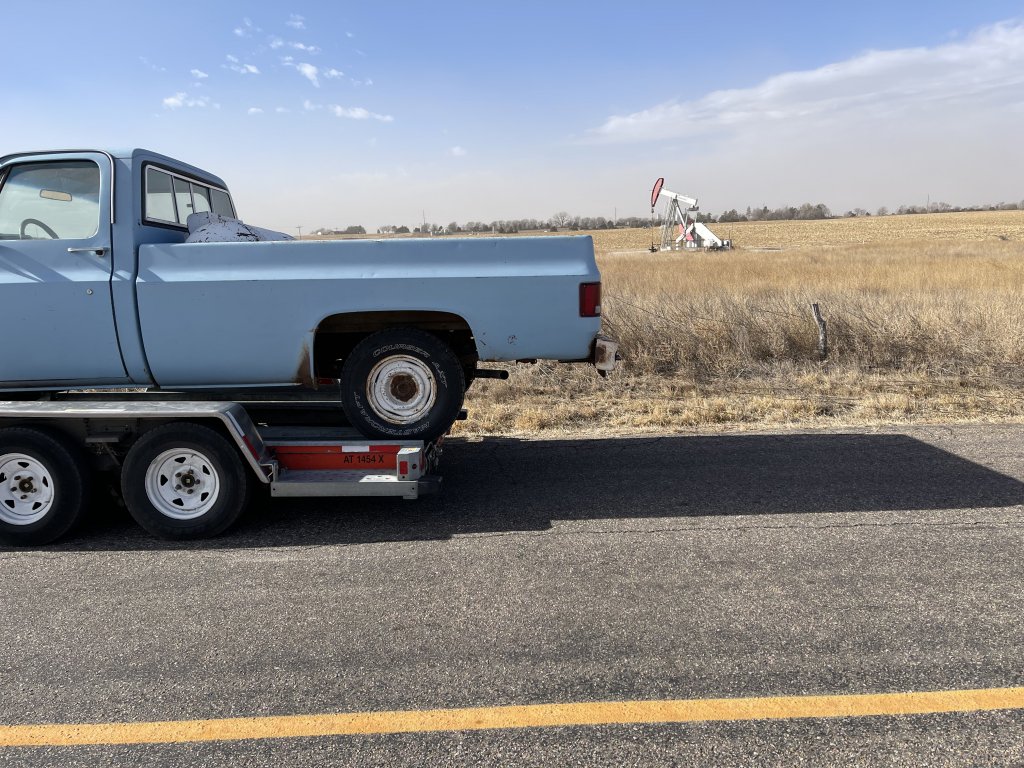

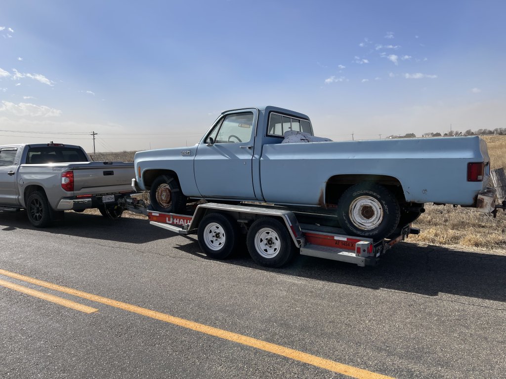

Towed mine with my 2021 Toyota Tundra from Garden City, Kansas back to south Louisiana, 800 plus miles one way, I rented a U-Haul car hauler for 3 days and went and got it no problems whatsoever, don’t think you’ll have any problems with a 3/4 ton truck Good luck to you

Wow! Hardly an inch to spare! I'm surprised U-HAUL let you load that size of truck! Rented a U Haul car-trailer like what you have there to move a '72 VW Beetle and the U-HAUL agent kept cautioning me about overloading it! Is it their job to treat everyone like we're liars? (lol!)
They just have no idea what they are doing usually, and have to deal with a lot of people that also have no idea what they are doing.
Thanks. Since I first posted this, I decided to look into weight distribution hitches and am seeing ones on eTrailer for 10K loads for about $350, not bad for my budget. And a couple others here suggested the WDH option too, so I believe I will spring for one and give my setup a safer, better towing capacity.
