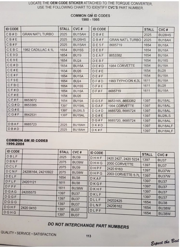

If I were looking for a performance upgrade,on a factory converter,I'd use this chart. The factory converters have a 4 digit code 1st digit is transmission type,second digit is stall speed. I don't remember the second 2 because they weren't important to me. First digit D 700r4/4l60 2nd digit is stall speed so a DB?? Would be 700r4 2025 stall speed. DBLF is a 1995 S10 700r4 2025 stall speed so still a reasonable choice for a daily driver by GM standards. Do not use parts store parts book torque converters by application,unless they can verify stall speed. They consolidate the applications,so they can reduce costs, you may order a converter for an S10 that factory was 2025 but may get a converter for an Impala with a1397 stall speed. Because most car owners will not notice the difference.
