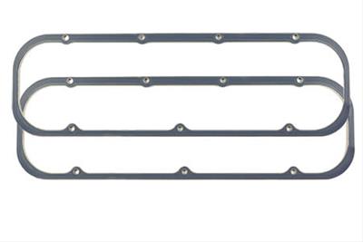

For any type of valve cover that isn't stock, I use something similar to the above. they are rubber with a steel core, reusable and never leak and although they are a little on the pricey side they are worth the money.
For any stock type valve cover, cork with a little glue is a good fail safe way as mentioned above. If you have stamped steel valve covers, another thing to mention is that you want to make sure the rails of the cover are flat, over the years they've been taken off and put on who knows how many times and usually over tightened in the process and will possibly be warped in the area of the bolt holes. Turn them upside down and lay them on the edge of your bench (the outer lip of the cover will rest on the edge of the bench and the body of the valve cover will hang off the edge) and make sure they are flat and if not, tap the gasket rails lightly with a small flat head hammer from the inside out until they are straight, it's worth the time to check and do. I've also seen many oil pan rails bent and tweaked just enough over the years that if i'm reusing either they get this treatment during the rebuild and installation. It saves on nuisance leaks for sure.
