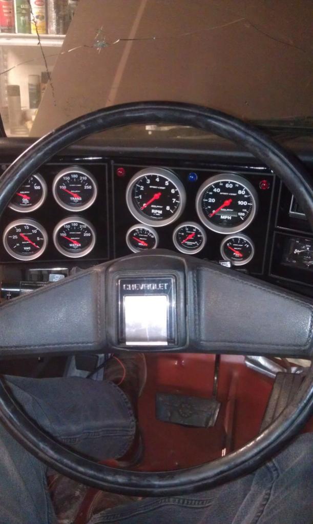

Did my dash this weekend. I'm really happy with the way it turned out.
Took me a few attempts to get the layout centered the way I liked:
With all of the gauges in:
And in the truck:
Thanks for everyone's input on this.
