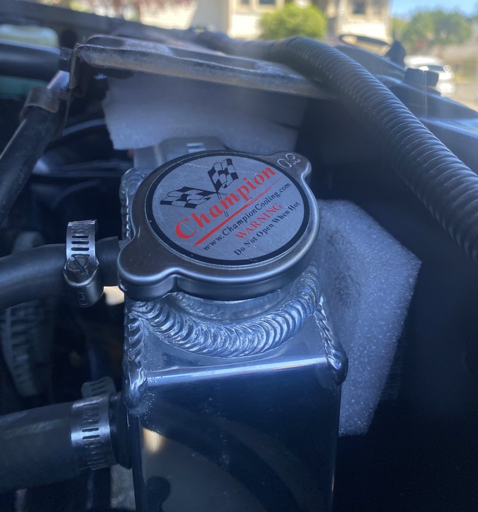

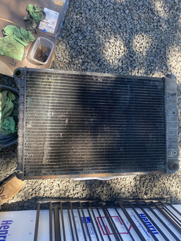

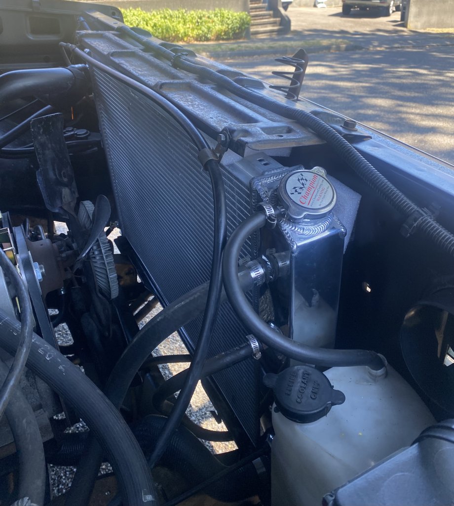

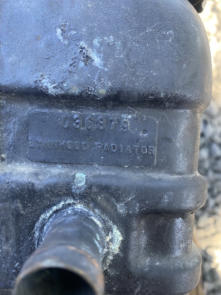

Alright so I ordered a Champion 3-Row CC716 replacement radiator. It was about $275 shipped. Installed it yesterday.
Overall I’m happy bc everything lined up perfect, but the height of the replacement is about an inch shorter than what was installed. Had to be creative with some packaging foam to get the top radiator bracket to hold the new radiator in place. It’s only temporary and I’m not super concerned bc that kind of foam has a relatively high melting point. I used the existing rubber mounts on the bottom but they are worn a good bit. I ordered some replacements to see if they give a little bit more height on the bottom to lift it higher.
I left the fan shroud off because it gives me better access to the front brake lines that I plan to replace next. Contemplating just going with 2 electric fans bc I like the way it looks and everything is so accessible. Heard SPAL are a good brand. Attached some pics of what I took out and the new one. I don’t have a reference to know if what I pulled out is really bad or not, but I’m happy I decided to just get something new.
Old radiator said Lynwood Radiator on it, not sure if that’s a common brand or if that’s original.
