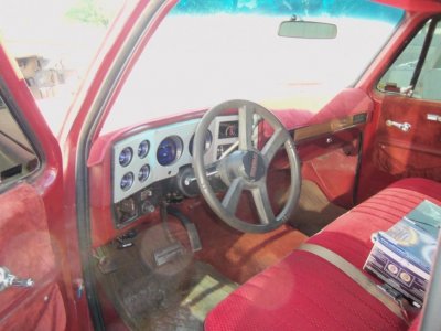

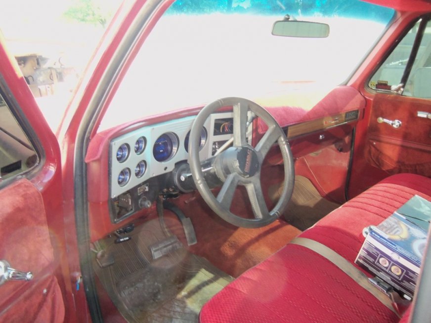

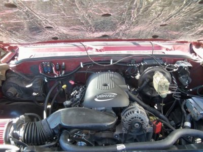

Here's a drive by conversion I towed to the exhaust shop to have pipes installed. This was a sweet truck and nicely done too. I think you can see that gas pedal in the one interior pic.
