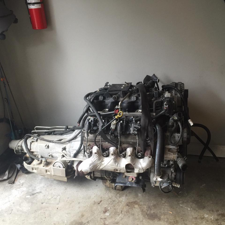

Bought the engine and trans from the 06

Woohoo! Exciting stuff!

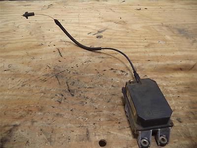

Again you can STILL have cruise control with a DBC throttle body. If you choose not to that would be your call, Just trying to clear this up for you or anyone else that may read this thread.
Yep, just need the cable cruise module from a 91'-up GM vehicle (Caprice, S10, etc).
attachment.php

Nice I need to go to the junkyard for some parts anyway and i'll see about getting the cruise module where would it be located on s10
foamypirate
3,302
467
Central TX
Jake (Mr. Wilson)
El Camino, baby!
5.3L/4L60E
I think they are usually on the inner fender on the driver's side.
Unless your switching to DBC you wont need that anymore. If your switching just find the cable and follow it back, usually mounted to the firewall. Don't forget to cut the wiring so you have a pigtail.
