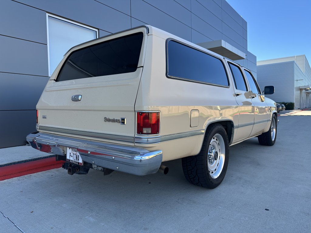

I’m running the 20” US Mag Scottsdales and I love them. Staggered 9x20 front and 10.5x 20 rear and I have clearance with a 315/35/20 rear and a 245/40/20 in the front.

Got the long lug nuts on much better. Center caps are being made with the bow tie:
Should look like this when we are done:

Front tires rubbed. Changed em out:

p-Tina is looking pretty sweet. I've tried looking around different threads to figure out where you ended up with lowering hardware- could you tell us the current parts list?
And current tire sizes? Is the big block and 4l80 all sorted out now?
Wester chassis front drop coils, western chassis front drop spindles. Rear lowering shackles plus a helper spring removed. 4l80 works great
