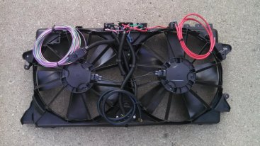

Before anybody frets about it-yes it's a Ford part but DAMN....it's one stout fan assembly! I had been researching the be all/end all electric fan options for those who want the best...well, here is my offering-it's a 2010-up F150 dual 14" fan assembly pushing 6000 CFM on high speed. I have this setup controlled using my unique 3-speed conversion harness. It uses a total of (2) 50A switching relays and (2) 100A load relays with parallel diodes for spike suppression. If anyone is running a BBC spec or 6.2 diesel radiator this may be an option for you.

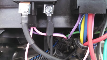

Closeup of the relay wiring...yep it's serious!!

Well I've been hearing all the buzz about the 6000+ CFM F150 dual 14" fan assemblies so I bought a new Motorcraft assembly and built the most stout version of my 3-speed control harness I could and after testing it out today-wow....this monster does move some air....with my inductive amp probe clamped on the output lead in free air, I measured 5.6A, 24.8A and 40.2A on low, medium and high speed. Definitely need a 140A alternator minimum to run it I'd say. Overall measurements are 34x19x5 not including the mounting "ears". I'm running 2 diode suppressed 100A rated load relays and 2 50A control and switching relays and there's no spiking or crazy inrush currents to worry about. If you guys want to play with the baddest fan setup around, grab an RF269 fan assembly and try it out-if you have the room! This particular setup is going into a Shortbox project of mine with a 454/diesel spec'd radiator. There might be a controller or two that might run it but I gave up on controllers quite some time ago. Anyway...there ya go-let me know what you think!

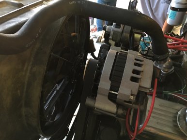

The Crown Vic fans are dual speed and I've used one in my 86 Shortbox and it fit nice with an aftermarket radiator. I always use the AC pressure switch or compressor clutch +12V lead as an override wired in parallel with the high speed switch wire.
My harness kits are supplied with either GM style temp switches or a BMW dual temp switch with all the correct leads.
I also like doing the stealth fan method-using an RF24 T-Bird dual speed fan and mounting it inside a stock truck shroud....
