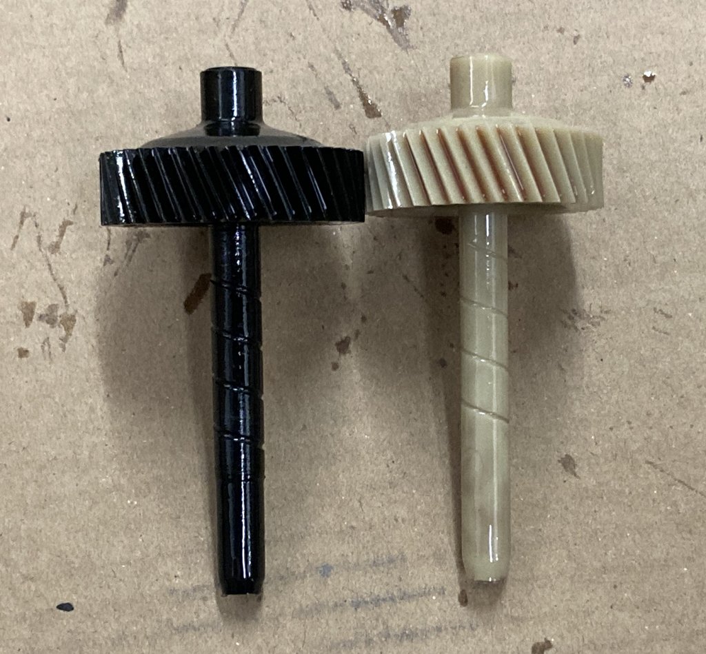

I'm dealing with a TH400 for the first time in my personal gearhead journey and am having issues trying to adjust the speedometer driven gear to get the right value on the speedo gauge.

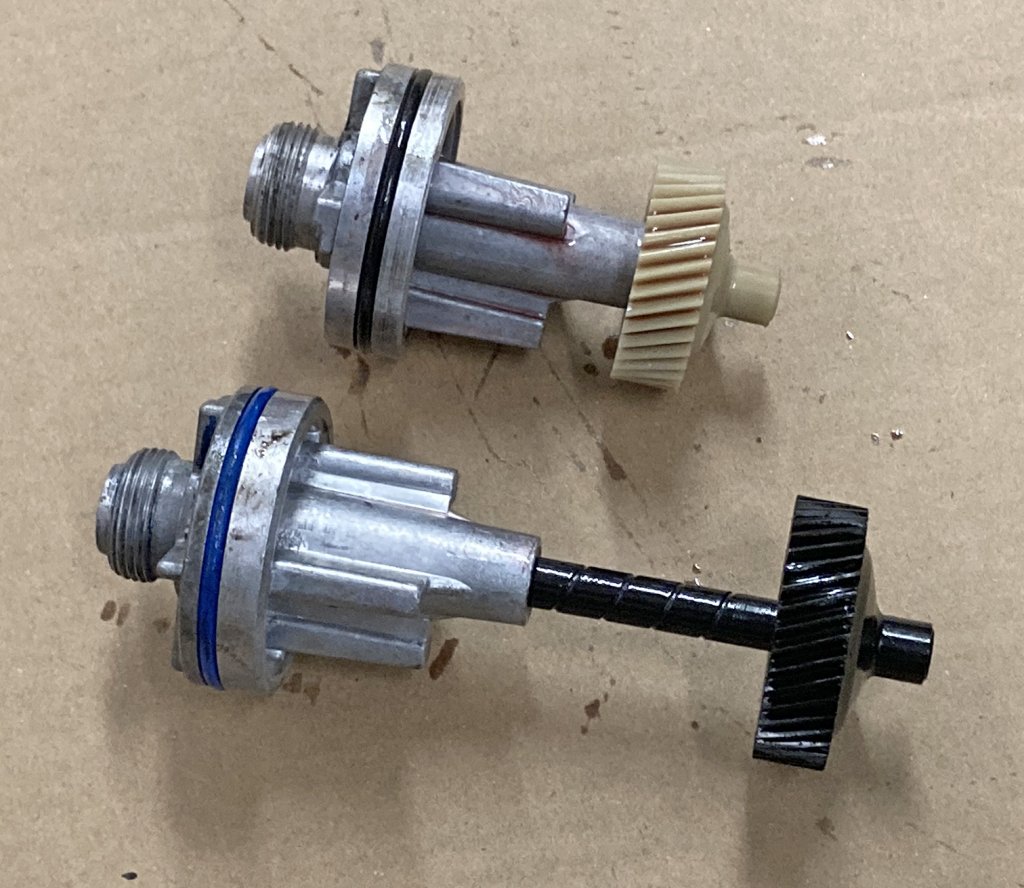

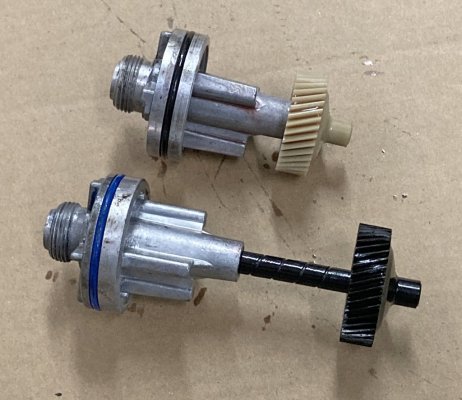

I swapped out the original 40-tooth gear for a 36 and thought it odd that the new driven gear didn't seem to touch the drive gear after installing it. But figured things would change once the truck got moving. But the needle didn't budge (just laid flat on the gauge).

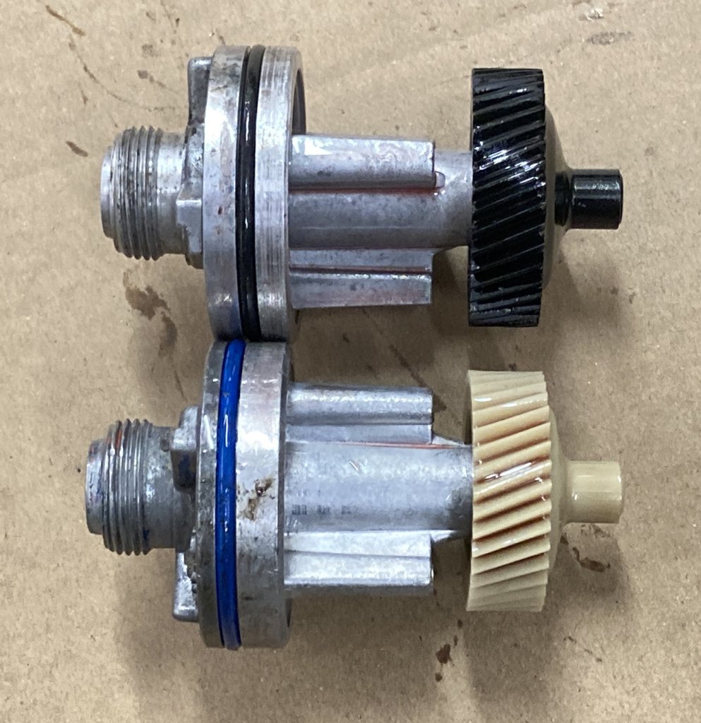

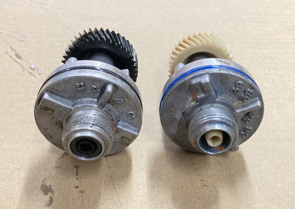

Then I noticed the numbers cast into the housing. So I found a different housing with the right numbers thinking it would have a longer snout to push the driven gear into the drive gear. But it looks to my untrained eye to be exactly the same.
I've yet to install this new housing, but figured I'd ask the audience what I'm missing before I try (and fail?) a second time.
Am I missing a bushing or something in this combo to get the driven gear to mesh with the drive gear?
I did notice you can't fit the 40-tooth gear into the 36-39 housing due to it having a very, very slight step in the shaft. But there's no step in my eBay-sourced 36-tooth gear.

What drive gear is in transmission I bet it has the metal gear

It's plastic as well.

Follow-up:
I plugged the 36-tooth driven gear into the 36-39 housing and plugged it into the tail shaft. Seems to work fine.
Problem is: I'm still 5mph too slow on the gauge. (Pretty much exactly the same as it was with the original 40-tooth driven gear.) :confused:

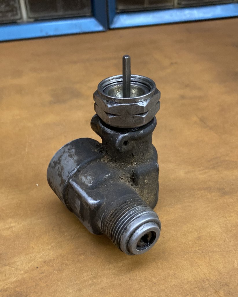

I have this convertor/adaptor that came on the truck when I first got it. It spins on both ends just fine (input turns the output as normal), but when I plug it in between the driven gear housing and the cable, my speedo needle just lays flat as I go down the road. :confused:
