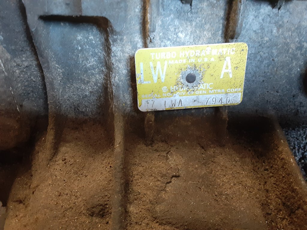

Hello folks, I'm in the process of rebuilding a TH400 transmission for my 1983 K20 4x4 project. It's a 1987 TH400 which will have the roller-type sprag. It's going behind a nothing-special 350 V8 to be used for hauling and towing, such as a stock trailer and farm wagons, so wondering if I should invest in replacing the drum and sprag with the 34 element?
If so, I understand that the drum from a newer 4L80e can work in the TH400. Can anyone detail what parts exactly I need to find to make it work? Will the inner parts of the original direct drum work in the newer one, etc.
Thanks for the help! I've been reading and watching everything that I can find on rebuilding the TH400 and hoping to get it right the first time. I've got some additional questions that will probably be getting posted soon.
