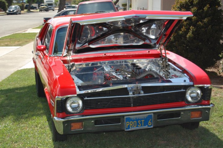

You want to put your 350 TBI R30 up against a 250 I6 Car??? I'll even let you have the move so we don't need a flashlight start. Oh wait, next you'll be saying but my truck is heavier. OK then, I'll give you a truck length out and the move. Five Hunnit Dollas and you want to do 1/8 mile or 1/4 mile??? Take your pic, he'll have you run down in the 60 foot and get that move and space back and then it's all she wrote.

I should have clarified, that Nova would smoke my R30 its bone stock and no AIR pump. We could have some fun and run similarly displacement I6s against each other with my TB. Nah, that would lose too, less weight and geared better. I love I6s, part of why I got a TB. Stock for stock a 6 can run with an 8, modified, its easier to go faster with 8 but would be more fun with 6.

That Nova is daily driven street car. It only does 13.20's in the 1/4 mile. It spanks OEM 4.6 Mustang GT's all day long and even those with a Flowmaster, K&N and chipped.
