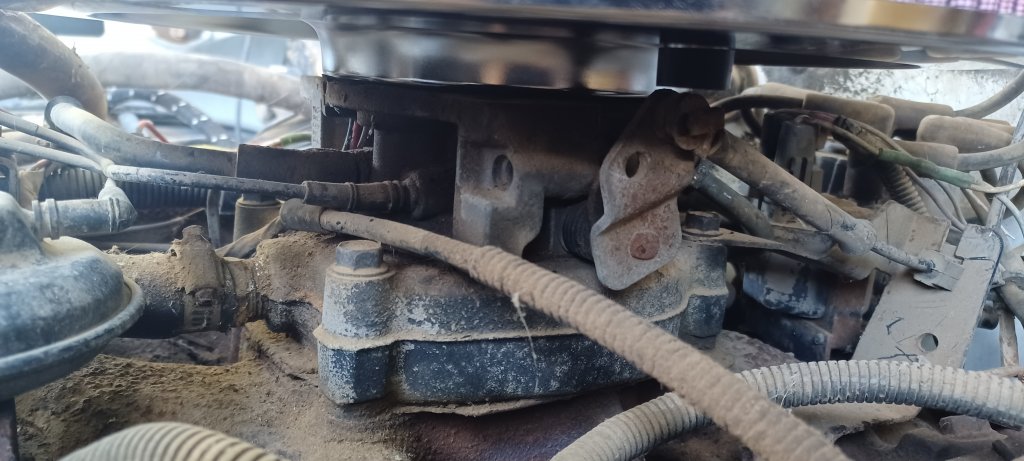

You'll know right away if you have one, look at your truck and look under the TBI. If there's a weird looking 1-1½ invh thick spacer with a coolant hose coming out of it, you have one.

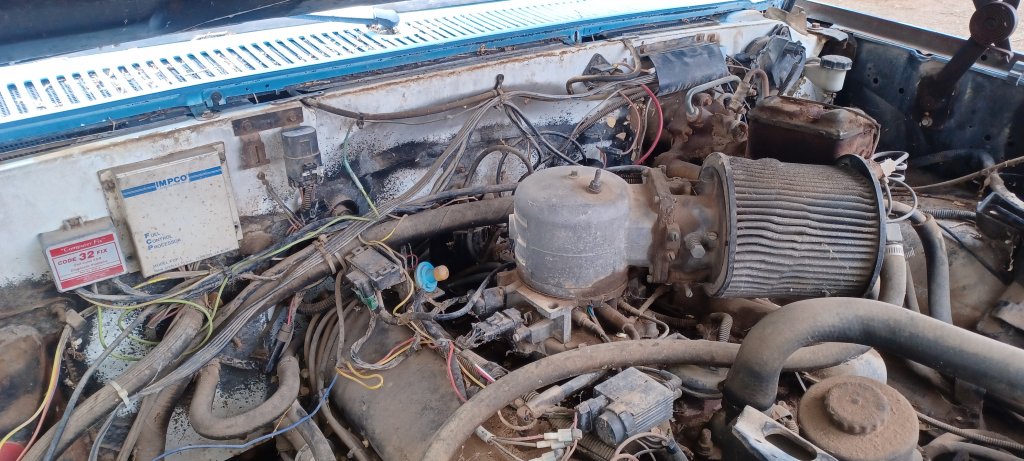

Do you have any pics of your engine?
Just this one. Can get more this weekend when I'm back home if you tell what areas might help this research. Currently has a Pimpco Propane fogger that I am in the middle of removing.
Did some rooting around on the truck this weekend. Does this look like the space you talked about?
Yessir, that's it. That means you have a spread bore 4bbl carburated style intake under that.
