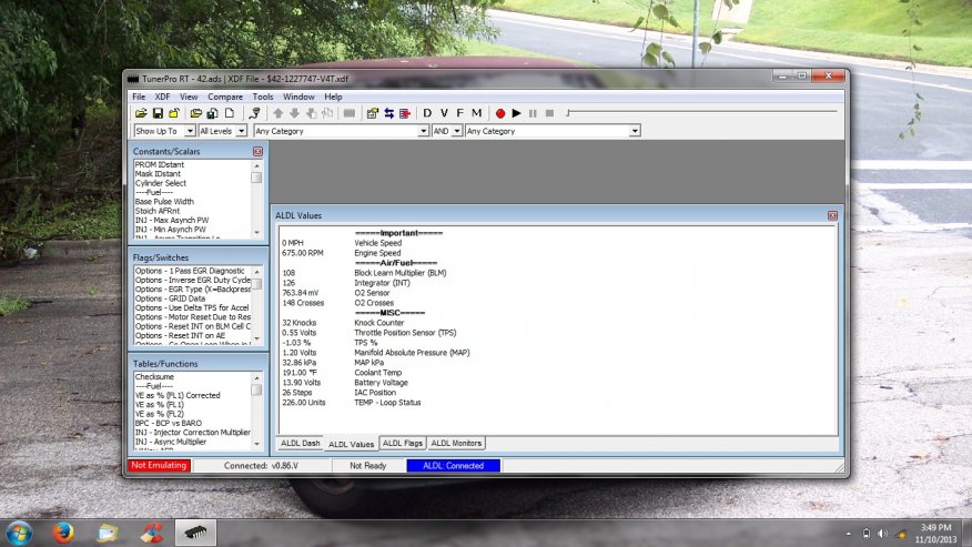

Okay, had to set the TPS to .55 because it skips odd numbers. No datalog but screenshotted TunerPro. Still runs pig rich and the BLMS and INT drops like a rock when idling.
MAP volts perfect. At normal op tem, go ahead and decrease the Throttle blade angle slowly....about 1/4 turn, and see if the IAC counts start to climb. see if you can get it around 30, and then reset the TPS.
I have seen Factory non adjustable TPS at .70v just as an fyi.
