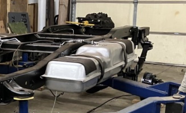

It's been a while but I don't remember having to bend the tanks much if any.
The pics don't show any...

These new tanks are visibly different from the originals. Look at the distance from the sender to the rear and where the original straps were. Also the distance from the rear of the tank and the spring hanger. I almost wonder if I had dual 16's (is that possible?). But the new tanks are definitely different / longer. I may have to fab a custom strap. Also wonder what fun awaits for the filler hoses lining up with the doors on the bed.
This is drivers side only...a couple pics are just to show where the original straps / were.

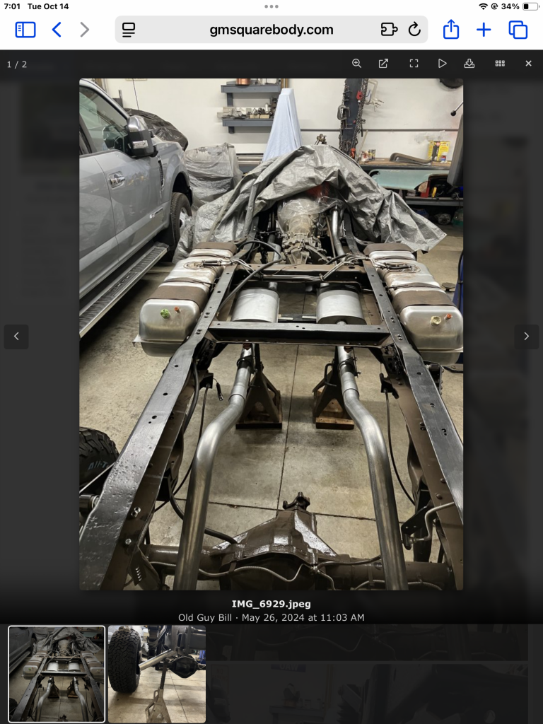

This is a '78 K20, with two Dorman 20 gal tanks.
