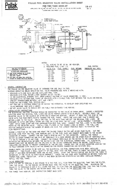

How do you feel about the need for the fuel pump return line?
All the extra ports do is vent the fuel return line back to the on-line tank. If you don't use the return line - then the 3 port style should be good.
I really doubt that if the caps are pulled off a U7000 it will function as a 6 port valve - no one would buy a U7001 if that were the case.

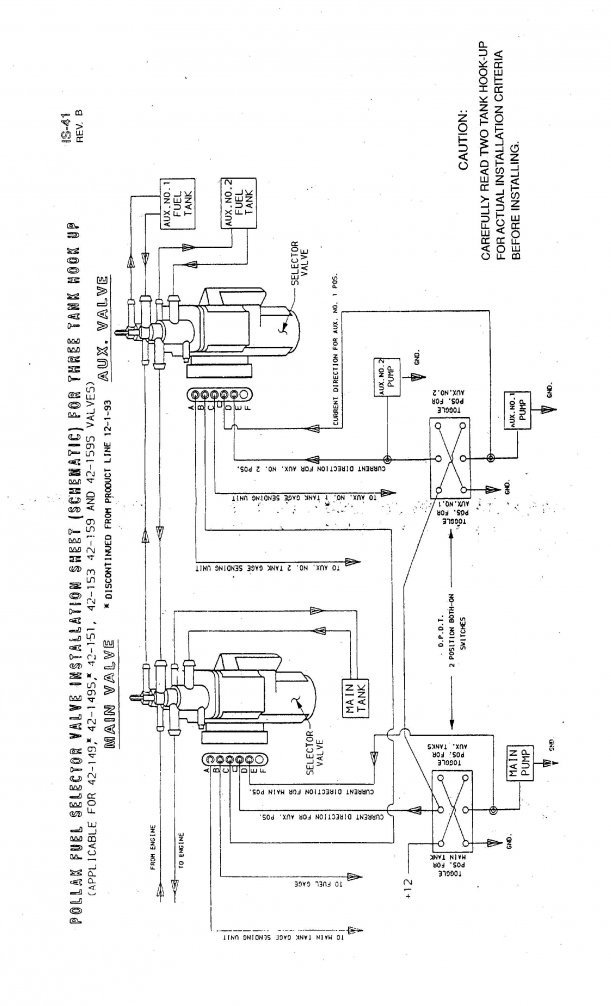

Spec sheet for a port Pollak valve - its identical to AC Delco.
  • Pages 1 from Pollak IS-41_b.pdf
  • Pages from Pollak IS-41_b.pdf

But I was dead wrong about turning a 3 port Pollak into a 6 port by simply pulling the caps off the nipples - so I am treading lightly.
I just spoke with Steve in engineering at Pollak - and he says..... ready? The valves are identical internally. His only caveat was to be careful when yanking the caps off. The glue that is used can take part of the nipple off along with the caps.
But bottom line; if you can get the caps off cleanly, you have successfully modified a 3 port valve into a 6 port.
