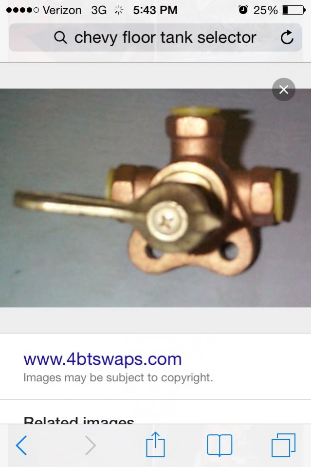

Looks like this sticking up through floor on passenger side
Witch direction should it b pointing

I don't know how it's plumbed, but whichever way the handle points is the inlet port that fuel flows through. Gas entering through either inlet port will go through the valve and flow out of the middle port. Like this:
You will have to do a little bit of experimenting/line tracing to determine which inlet port leads to which tank. But, it would probably be a safe assumption that if the point on the handle is indexed towards the RH inlet port, the RH tank is on line.

Thanks actualy didnt see the little pointer opisite of the handel
I was pointing handel at the tank i wanted so was completly backwards
