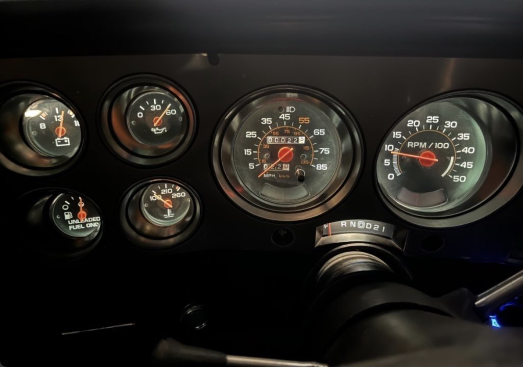

Anybody make an in dash tachometer to replace the fuel gauge for six cylinder engines? 1977 K10 with the 292
There’s a guy in Louisiana that makes repro boards to repair the factory tachs in 80s Camaros/Firebirds/Trucks/Vettes/etc. I used his board to fix the factory tach in the cluster I built for my truck. It was around $60. He includes a potentiometer soldered to the board so you can dial in the rpm yourself to get it correct. For me, with a lockup torque converter/3.73 gears/31” tires, I know that at 70mph I’m turning around 2kRPM so when I got the tach board installed I just ran a few passes on the freeway, pulling off to adjust with a small screwdriver until I had it right. Cajun Tach Shop is the name of the business. Sells on his website and also eBay. He might could build one that would read pretty close for a 6 cyl or just buy the same board I did and dial it in yourself. Wouldn’t even need to mess with running on the freeway and pulling off to adjust if you’ve got a timing light that’ll also show you rpm, could dial it in in your driveway if you’ve got that.
Just checked and it says on his site that he can set up a truck tach board for you for 6cyl. Just let him know when you order that it’s for a 6cyl.

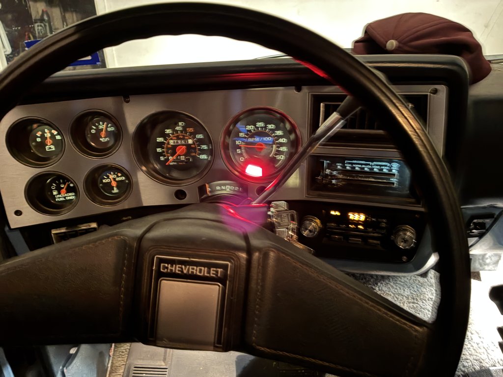

A lot of that info is good but some of it is bad. It states in there that you can’t run a factory tach ‘87-‘91 because of the VSS/ECM/etc on TBI trucks and that’s just not true. The white wire running off the coil on the TBI trucks is a tach signal wire and it works just fine with the GM tach in my 1987 5.7 TBI truck with a VSS on the back of the speedo for Cruise Control and for the ECM.

Yes, like anything from the internet can be wrong, the pictures linked show the gauge faces from the different years. That might be useful for someone trying to match what they have.
Agreed. I wish I’d have taken a pic of the 1985 cluster I bought for parts just to have it up there because there were slight differences. The redline marker on my 1985 tach is white, the 1980 Canadian cluster pictured on that site is yellow/red. I’ve never seen a 1980&up repro tach with a redline marker. The 79&down repro ones have it. There’s differences in the markings on the fuel gauges too, large and small. ‘87&up they use full/half/empty circle markings, prior to that it’s E/F isn’t it?
I also wish they had pics of the backs of the clusters because that’s why I think they say that you can’t have VSS and the tach. The tach cluster back on the 85 cluster I bought had an opening for the speedometer in the rear that was too small to allow for the plug into the back of the speedometer for the VSS. The ‘85 Speedo I got had the window on the back of it for VSS and an untapped hole for the screw to secure the VSS plug but the ‘85 tach cluster back speedo opening was too small to accommodate the ‘85 speedo if a VSS was connected without trimming the cluster back to clear it. Also, the 1987&up speedometers have a larger back than previous years so neither my original ‘87 speedo or the NOS ‘88 speedo w/trip odo I bought to replace it would fit the 1985 tach cluster back without trimming material off the cluster back with a dremel. The tach cluster backs that most of the places like LMC/USA1/etc sell these days look like they’re set up for the ‘87&up speedos which means that all the earlier ones will fit too. Anyway, I just had to remove the speedo cable clip from the 85 cluster because on that cluster it screwed to the cluster back, then trim the 1985 tach cluster back to fit the ‘87&up speedo, and use the ‘87&up speedo cable clip because on the ‘87&up speedos the speedo clip is screwed to the back of the speedo itself.
