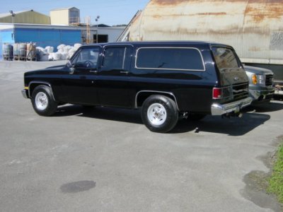

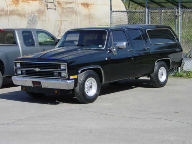

dayum... sick burb. props.

NICE! What size tires are those by chance?

Nice nice nice!! Is it lowered a little in front? It looks a little lower than mine.
Looks like 235/85/16

It is lowered all the way around.....I'll hafta check the tire size. Thanks for the kudo's, Guys.

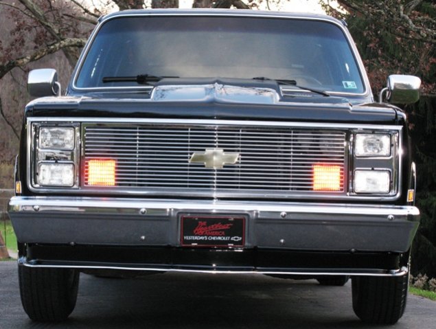

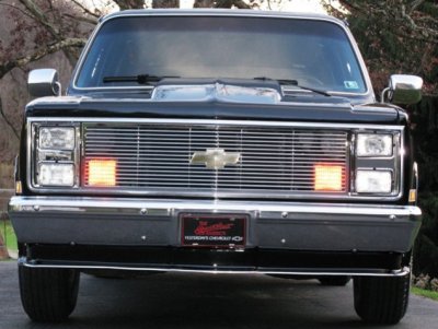

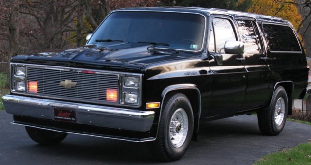

:cheers: Few more improvements.....
New Michelins (235/85/16) , New Grille and Bezels and a new front spoiler.

Where did you get the front spoiler? I wasn't sure they made them anymore.
