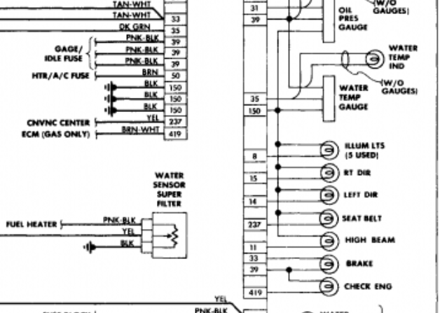

Then the 419 BRN WHT wire to the ecm is the ground wire. follow this to the ECM connector, I would personally either probe the wire to see if it has ground (use a sewing push pin, pierce, then alligator clip and then go to your make shift bulb or SES. Then provide it power or turn the key. Work? Then its the wiring from that point until the cluster

No you dont seem to understand what we are saying. The wire from the PCM does NOT power the Bulb. The Bulb is "powered" by a fuse in the fuse box. The bulb has no ground except when the ECM chooses it to be
So the ground from the pcm is the wire that connects it to the PCM. which provides it ground. the ground then goes through the ECM ground on the intake or whatever.

My brake lights do work, yes. But I feel like we're saying the same things, and that maybe I am just relating it poorly.
I followed the flow chart above for "Does engine start" = yes. I pulled the battery leads, I disconnected both harnesses from the side of the ECM, reconnected the battery leads, turned the key to on, inserted a t-pin into A5 on the ECM harness, which is the brn/white wire for Circuit 419 shown in the second image, and grounded that using a 12v unpowered test lamp connected to chassis ground, and the SES light illuminates as long as I probe it. That would say to me that power is flowing up from the fuse box, through the cluster, and my 12v unpowered test lamp can successfully complete the circuit by taking C419 to ground right? I didn't feed power into it using a powered lamp or anything, I just completed 419's ground path using my unpowered test lamp connected to ground as the flowchart suggests.
To ensure the ECM can actually ground anything, I left the key on, put a t-pin in b1, a 12V feed on the A/B harness and probed A12 (edit: this was supposed to be A12, system ground, I am a bad thumb typist), the system ground on the A/B harness, as well as C16 (12V) to D1 (system ground) on the C/D harness to confirm I could send each 12v feed on each harness to the system grounds. Both illuminated my unpowered 12V test lamp. So both of the ECM's ground paths are good. That would say that if the ECM were doing the diagnostic portion of it's startup, it has all the necessary paths to ground C419 through to either of it's harness grounds.

So, just wanted to provide an update and closure. After the diagnostics last weekend proved the ground path to the ECM was solid, and that with key on grounding C419/pin A5 to the chassis allowed the light to kick on, I debated, then I opted to order a remanned ECM from ACDelco.
Just got it in this AM, swapped a minute ago after transferring the PROMs over from the old unit. Lamp is now on at key on, and disappears while running.
Once I get the dash back together (I took the pad off, reaching through the AC vent cavity let me get more light in there) I'll take it for a drive cycle then check for codes, but, we're at least solid on a solution here.
