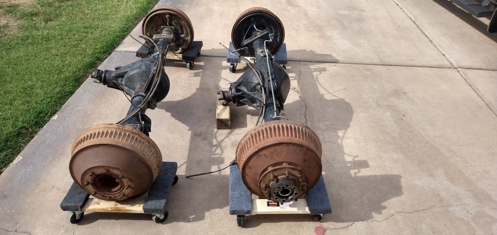

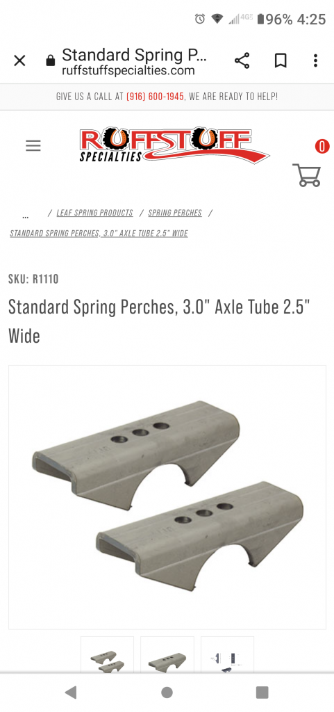

To follow up on this, I just swapped my SF back and forth with my FF while I pulled out the locker. I specifically measured the difference in pumpkin length. The FF is actually (as mentioned previously) shorter by 1.1 inches. I've run them both with the same driveshaft with no issues. However, under full compression the yoke engagement gets a little sketchy as the axle moves backwards. Fortunately, I used spring plates with provisions to move the axle forward or backwards 1 inch from stock. When I put the FF back in I simply moved the axle forward 1 inch and all is good. The ORD kit and spring plates are way cheaper than a new driveshaft. You have to move the perches anyway to put the FF in a K10/20.
Appreciate the info. Since this is coming out of a C20, and going in a C20 I'm hoping not to have to move the perches, but perhaps a guy could drill a hole in the existing perch if need. I think at this point I need to get the diff here and then go from there.

Right, it should be a direct fitment, besides the brake cables. The spring perches will be cast though, with nowhere to drill a second locating hole. It may not be needed with your 2-peice shaft. I believe your driveshaft splines have more engagement than a typical 1-peice shaft with a slip yoke in the trans.
Thanks, that's what I thought should be direct fitment. This makes sense and maybe why I hear so many different answers to the driveline question. So I had mine out a year or so ago to replace the U-joints. IDK how long the front shaft goes into the tranny 4 inches maybe? It's pretty long. The carrier gets bolted up and then the back part slips on. My thought kind of is that if I pull the carrier (which if I remember right has slots in the frame.) If I pull it back 1/2" then the rear shaft only has to make up 1/2". Add to the list I'll need new U-bolts.
