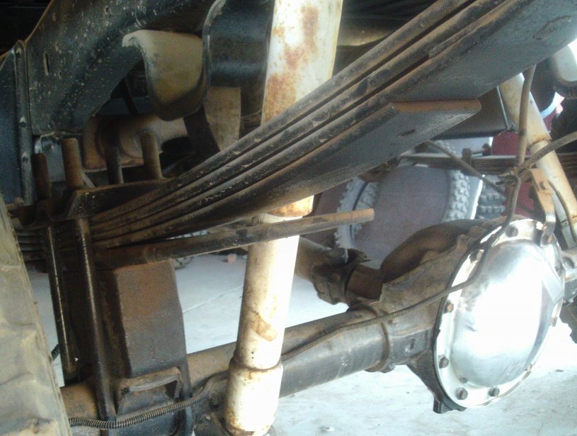

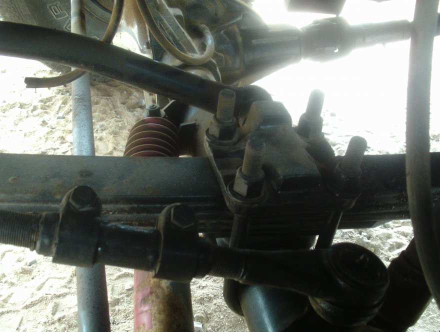

If you could throw up some closer photos of the current front and rear suspensions, we could help you further with what size and style lift you have.

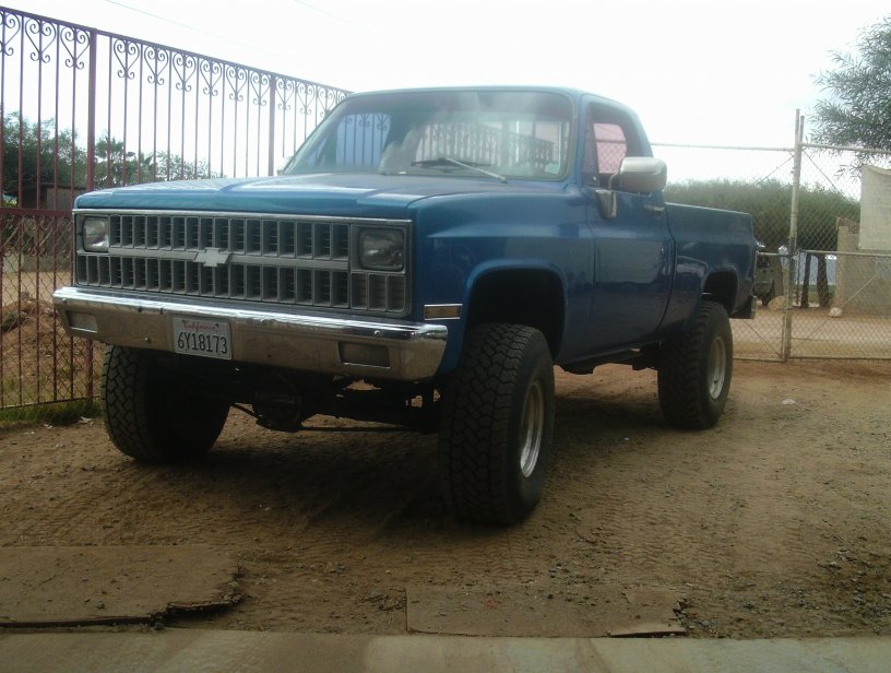

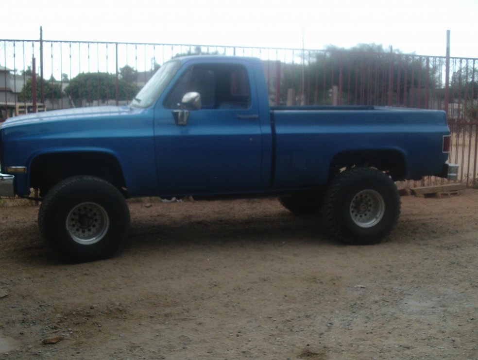

With the 4in block in the rear, I would assume that you have a stock leaf pack back there. And from the pictures, your truck looks pretty level. Thus my thought would be that you have a 4in lift all the way around.
The front pack looks like it may have been rearched with extra leaves added in. That would definitely create a rough ride in the front. Rear will always be a little rough since there's no weight back there as of yet.
There were tens of thousands of these trucks produced all over the country. Parts for them are very easily found.
While you're on the suspension, I'd definitely take a look at the bushings on front and rear shackles. If those are dry and cracked to pieces, it's certainly not gonna help your ride any.
Also, as a frame of reference: My truck has approximately a 5" lift in the front on a set of 35x12.5R15 on a set of 15 x 10 wheels. From ground to the center of the front wheel well is 41.5" on my truck.
Assuming you have a 4in lift with what looks like 33" tires, you'd be approximately at 39.5" from ground to the center of the front wheel wells.

My truck has 35x12.50 tires. If I change leafs,I would like to keep same height as now. Im about 41 1/2 in from ground to wheel well edge. Picture rear leafs/with 4in blocks. So if you think rear leafs are stock. How about shackle flip kit,then I will need shorter U bolts. Chuck the blocks,also the bottom overloads. This truck will never be used to haul,as I have 3 other trucks to haul.Also yes on needing new bushings. The transfer case looks like it has 1in drop.
