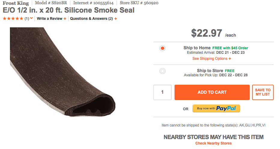

I ordered 2 different brands of weatherstripping for the barn doors: one was Precision Restoration Parts, and the other was Metro Moulded Parts. Both were good quality, but had the same problem you guys have described. With one kit, I couldn't even close the doors even if I slammed/forced it! Of the two, Precision weatherstrip did have a bit better fit, but still too thick. I have replaced all weather stripping with precision: front and rear door seals, front and rear beltlines, glass runs, and hood to cowl seal - so I'm disappointed I can't find something that fits. I checked my gaps and everything looks square (no pun intended), so I don't think it's the hinges or latches that are out of whack. I would have to make some major adjustments for it to fit (and 89suburban didn't have any luck with this workaround anyway)
Here's my plan:
1) See if I can find a decent set of weatherstripping from the junkyard (seems unlikely)
2) Use something from home depot intended for home use, like this:
210391[/ATTACH]"]
Here's my plan:
[ATTACH=full]210426[/ATTACH]
I removed the LMC crap and used 3/4" wide by 7/16" thick foam weatherstrip from Home Depot. It actually turned out surprisingly well. However I believe 1/2" thick is the perfect thickness to uses after this first field test. So what you have found right there may just be the ticket.
