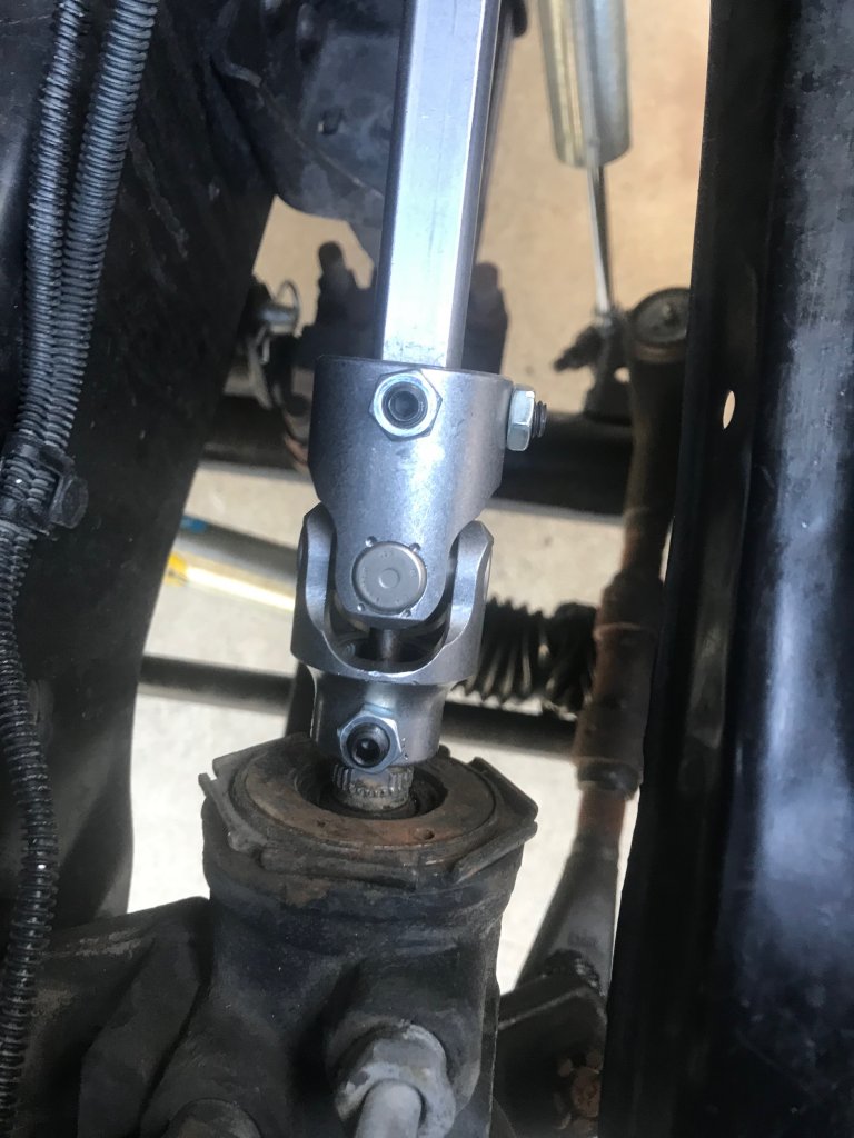

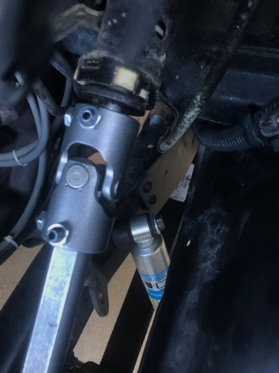

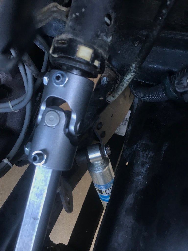

Borgeson makes a shaft to eliminate rag joint
