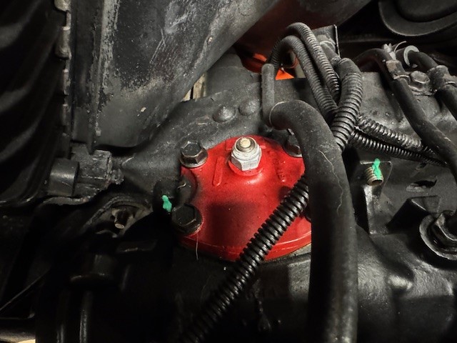

Echo all of the above. plus check for loose steering gear bolts to frame. Any looseness will make it super squirrelly esp at speed. Easy to check -rotate steering shaft back and forth while observing for any steering gear to frame movement.
saltdog
Aug 9, 2020
173
218
US
K20 Suburban

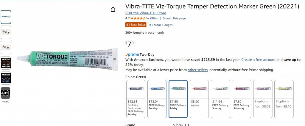

Its really a good idea to check the torque on everything too. Once you know torque is good you can apply "witness paint" to make sure nothing changes or if it does- its easy to see. Basically the paint line breaks if anything moves. Here's what I used and did for my steering box
