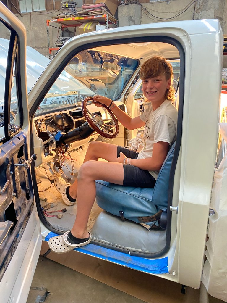

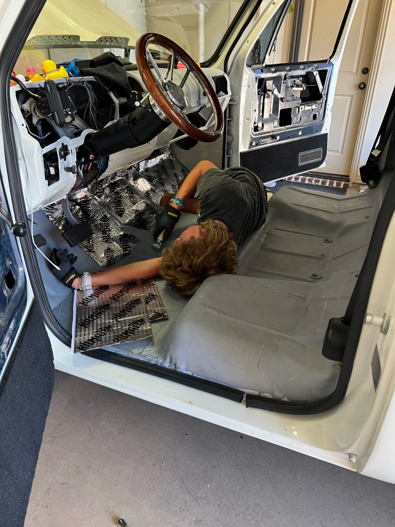

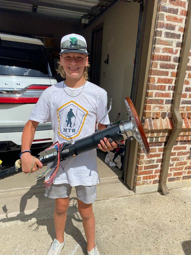

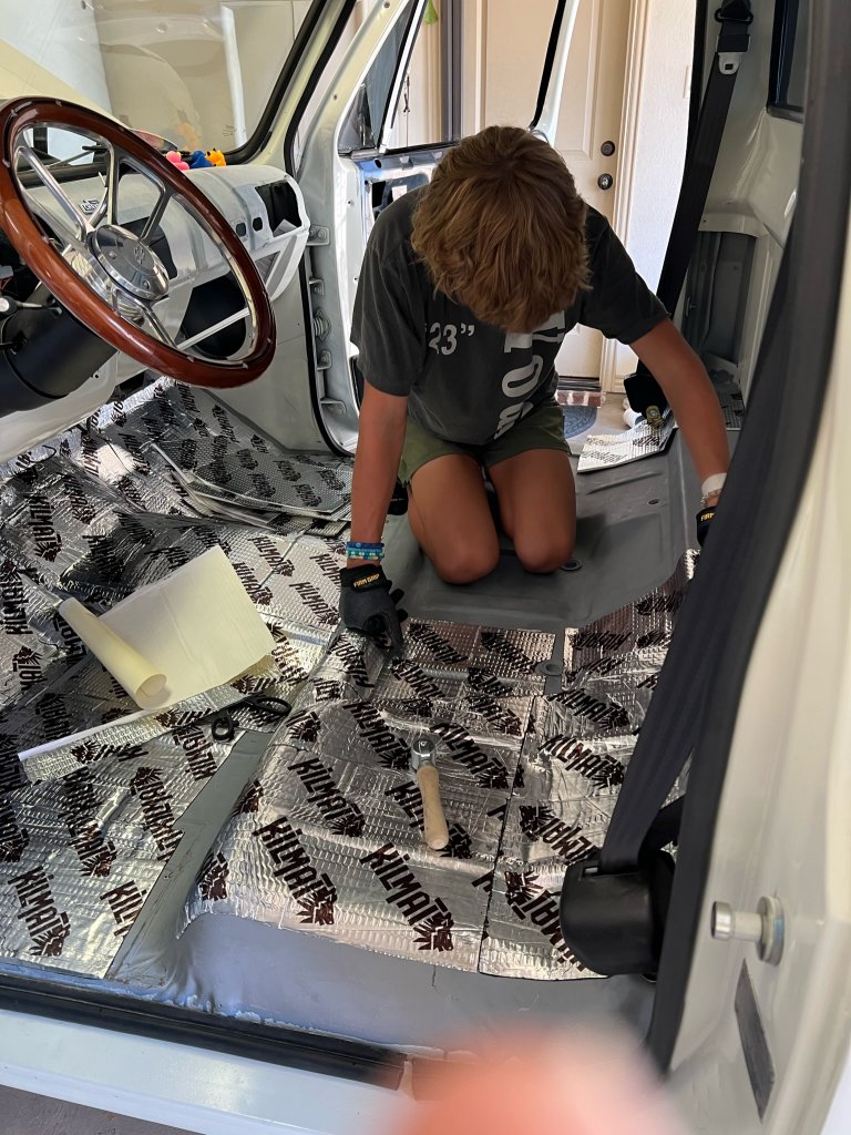

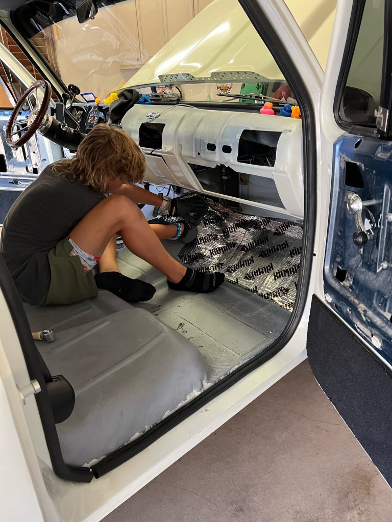

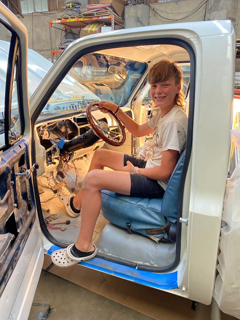

What Matt said above, easy unless you add stuff. Easton did his with little help from me…
