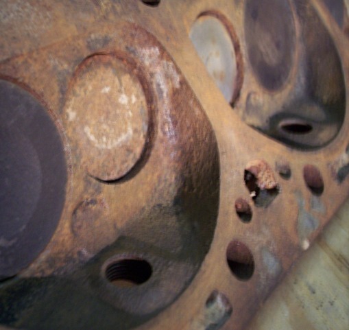

No backfiring at all huh??? Either thru the intake or exhaust? Do you have hardened seats in your heads? Now that, i've seen before become a problem. Usually 3, 4 or 5 seats are actually bad but only 1 be bad enough to be ticking with slop in the rocker/pushrod train. But even then, it's usually gradual, and get worse and worse.
Here's what a head looks like with non hardened seats and unleaded fuel. Ohh ****, and you're in Cali with that high alcohol content fuel too.
