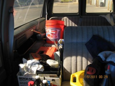

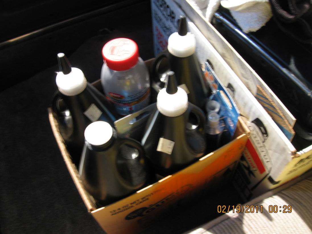

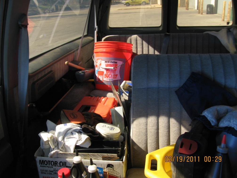

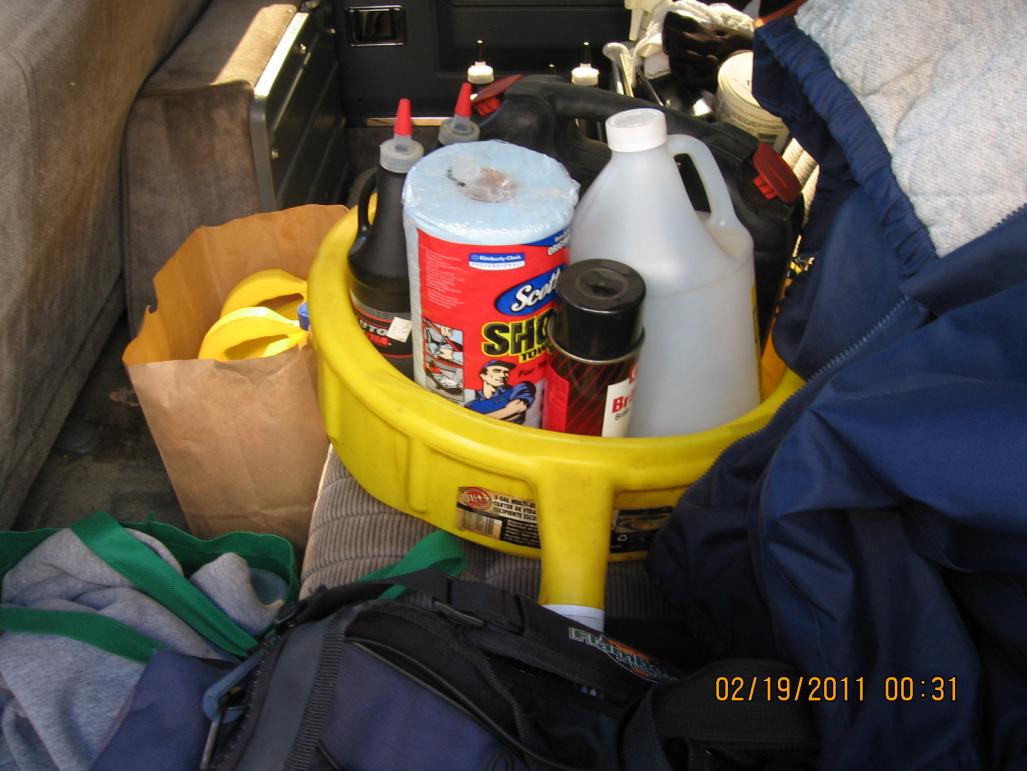

Ok, brought all this **** to work with me so I can do the gear oil changes later today. :High 5:
47,859
11,038
hahaha, did you get enough oil for the diff??? How many times you gonna change it???

One thing I did not notice in your goodie box is the tube of limited slip additive, I think its voodoo but use it anyways.

I'll say this, I am a hater of just about every additive possible. But when it comes to that additive for diffs, if the book or dealer calls for it, USE IT !!! It pretty critical in those rear ends that require it for some reason. I am thinking he is OK without though. I am not even sure the G80 locking diff requires an additive. My 2003 Avalanche with G80 didin't but it required the dealer gear oil at $35 a quart and it took a quart and half, so 2 quarts was $70 and I still have half a quart.
