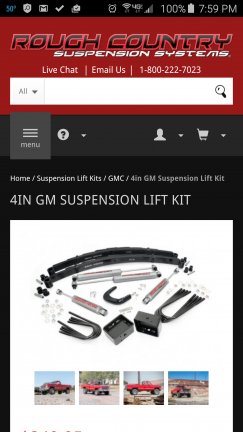

Squarebody_85

The lift

Your new kit is just a 4" block for the rear.
You will need to get some stock rear springs, your current springs are 8" over stock.
