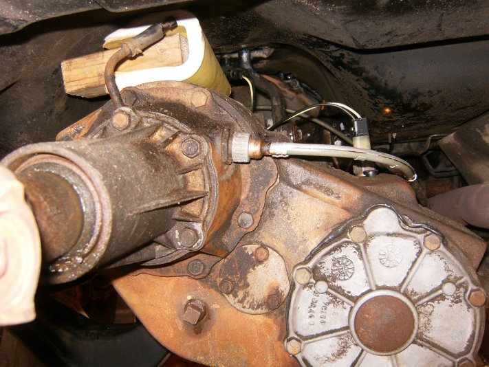

Not mentioned is the model no. of the transfer case.
Here is a shot of how the cable mounts on a NP205

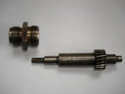

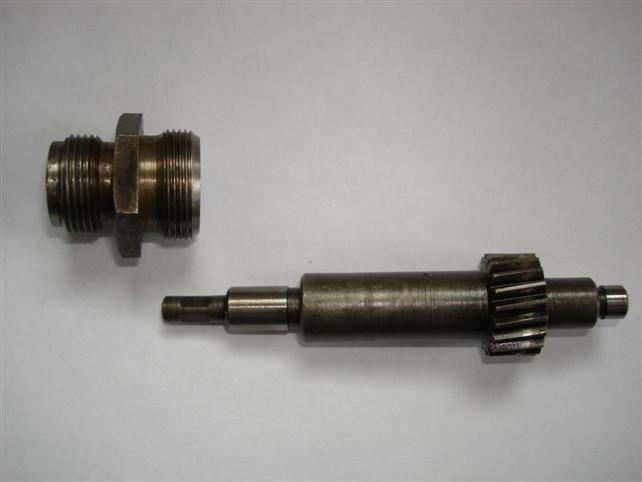

An NP 208 has that adapter plate that is indexed to match the number of teeth on the gear.
Look at the gear holder housing. It should have an off-center hole for the gear, so it has to be inserted with a specific "clocking", as there are different gear diameters for different tooth counts. You read the numbers on the side, match that to the tooth count you're using and that mark lines up with the mark on the case. If this is wrong, the spacing between the drive and driven gears is wrong and could lead to premature failure (or a non-working speedo). You'll see that the little hold down tab can hold the housing in different orientations.
Some visual aids:

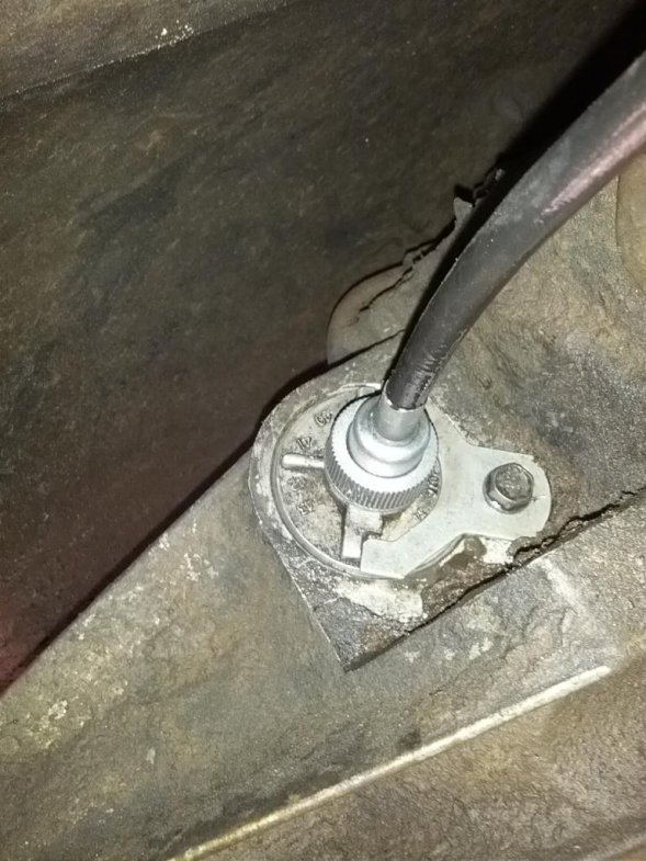

Here's a pic of what I have going on underneath:
Looks like the 205? Would someone add this for bigger tires/different ratio? Anyone seen one like it before? Thanks.

Does that adapter have an electrical lead?
scottyknows50
May 13, 2013
9
Ames, IA
Scott
No wires to it. I took it off and the cable still didn't work. I thought I read that there was a gear that breaks in the transfer case that drives the cable. Guess I'll have to search for that. If anyone can point me in the direction of a "diy" it'd be appreciated.

the adapters are common to round off the input shaft going in them. replaced many of them. last one was bought at dealer and like $35
