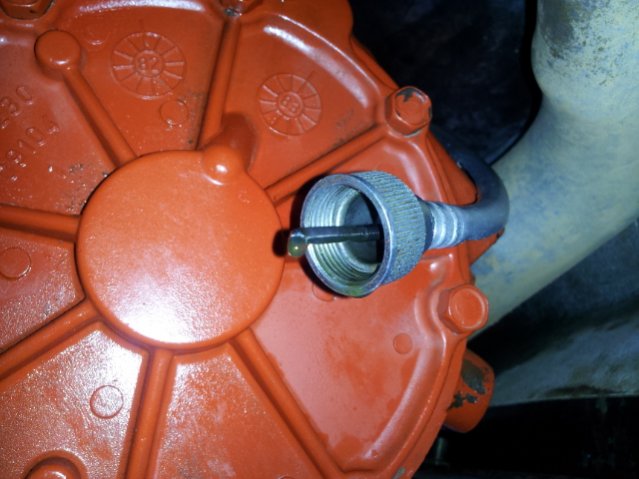

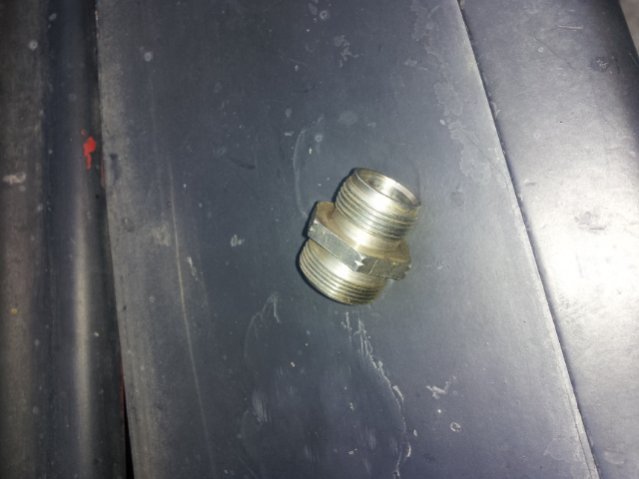

Got it in we will see if it continues to leak tomorrow. .

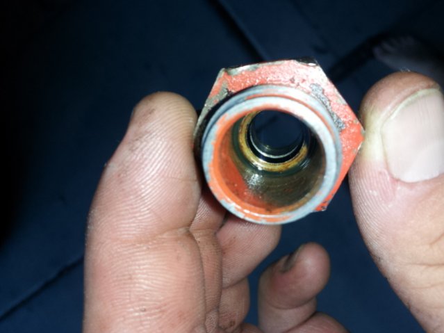

Hopefully that does the trick. There's two rubber seals in that piece, and, after 30 years, rubber age-hardens, not to mention the wear.

Old seal was non existing
