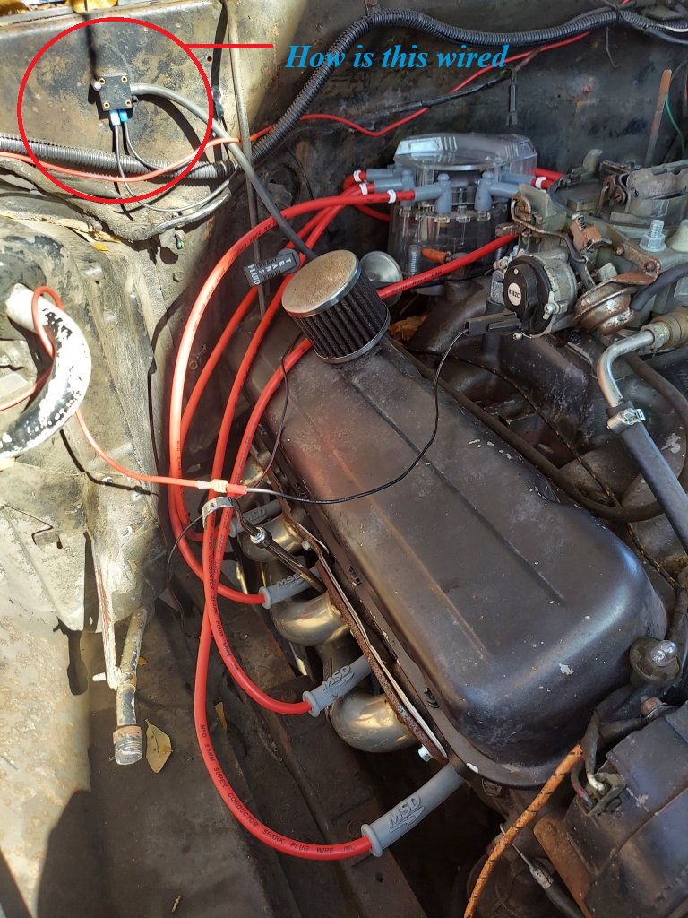

82sbshortbed----- how do you have the choke wired and also how do you have this (circled in red) trans thingy wired Please. i need to wire up a choke and also need to get the trans switch square thingy....​
Is the choke just wired to a hot ignition on

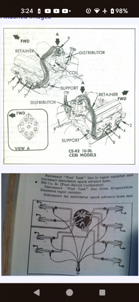

I have a stock 77 350. I'd like to route a new custom 'cut to length' set of wires like this, but I want the nipple for the dist retainer ring and 90 degree plug ends.
I'm having a hard time finding that combination. I found one set like this, but they are 10mm wires and I can't find a crimper that does 10mm wires. Any suggestions?
Thank you!

Do you know how the were routed factory. Just checking,a lot of people dont,and assume the wire are too long because they don't realize they are supposed to go down the back of the block,under the exhaust manifolds, and up to the plugs. If you are trying to go from the distributor over the valve covers and down to the plugs look at a set of wires for a 1976 1/2 ton with a 454 Napa #700242
