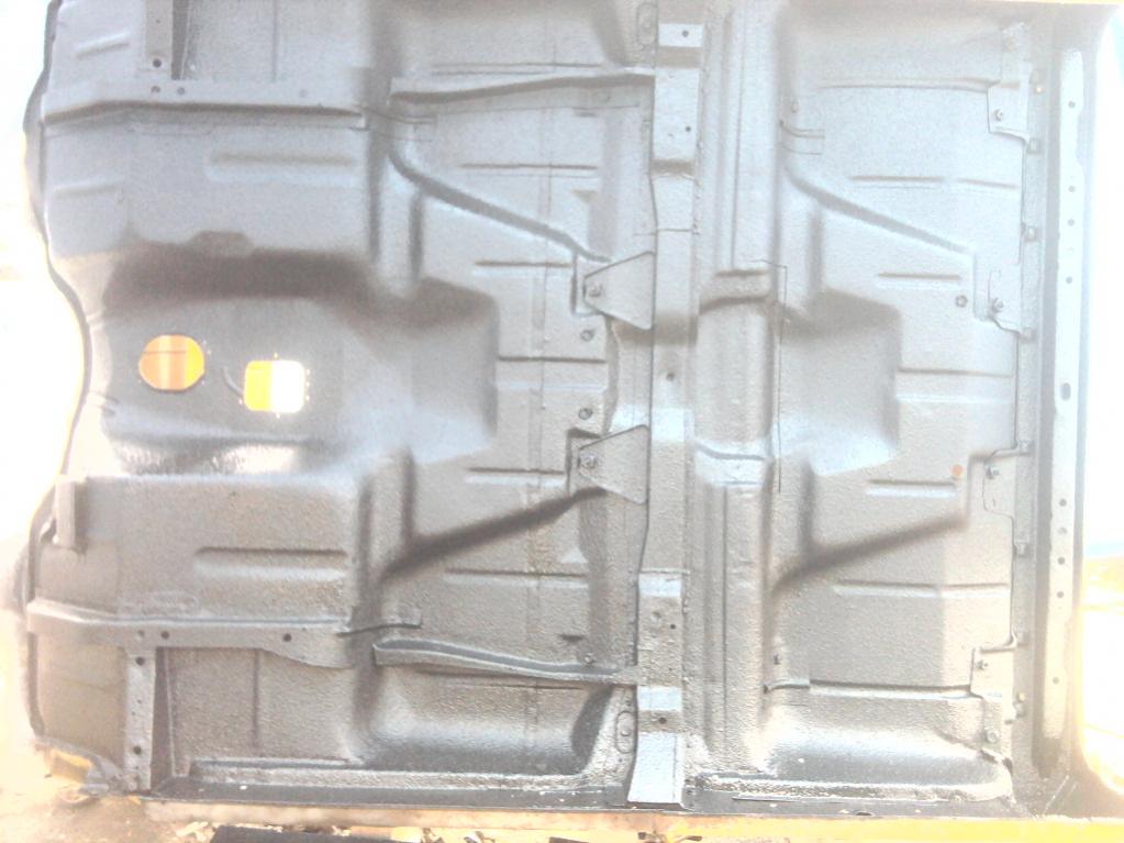

i am useing a do it yourself bed liner they sell it as a roll on but it can be sprayed.
i sprayed my underbody and am about to spray it on the inside.
monstaliner
http://www.monstaliner.com/
