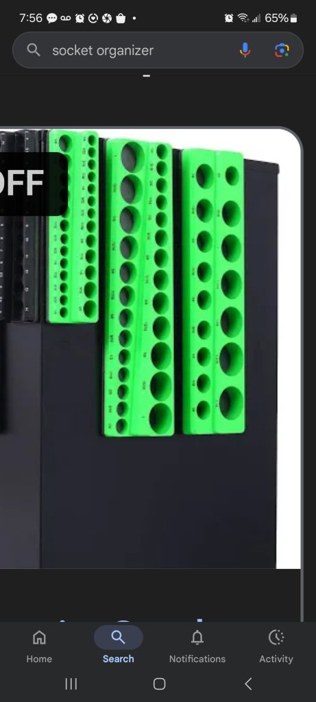

Socket organizer need help for homemade

Apply mold release to sockets, arrange in your form, mix resin really-really well, pour to the depth you want and wait for it to set. Hardest part I imagine will be devising a way to keep the sockets from moving around when you pour it into your form. Stuff is really easy to work with.
Could screw them down to a board with deck screws…
