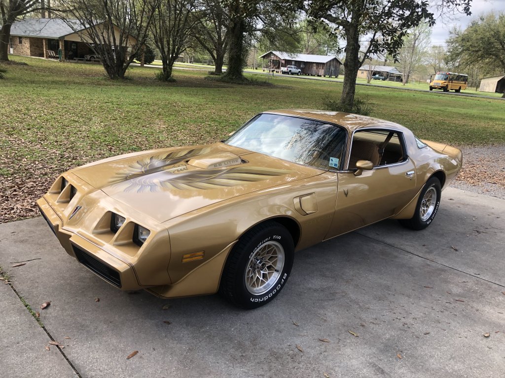

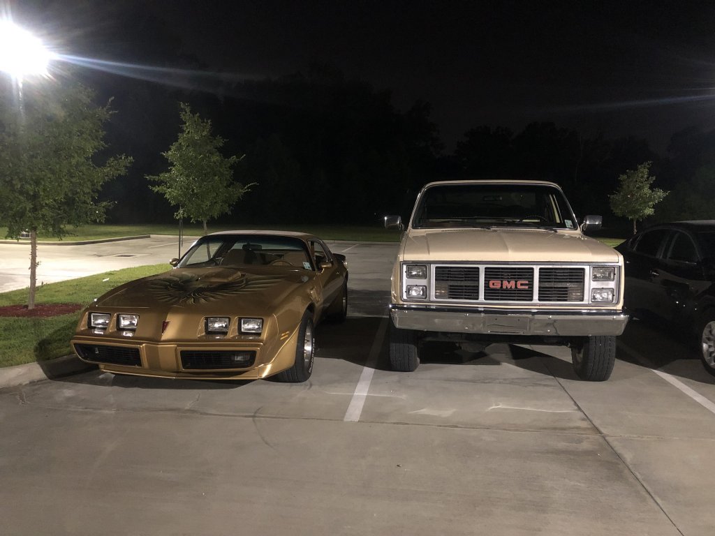

I am not an expert on Trans Ams but I do play with one from time to time. If that was actually a 301 Turbo, I think those didn't show up until 1980. They didn't have the shaker hood like your car has, the scoop was off-center on the driver's side. Your wheels appear to be from a '77 model.
In 1979 there were some Trans Ams with the 301 but it was not a turbo...as far as I know. I do know that in '79 if a Trans Am came with a 4 speed manual it had a 400 Pontiac rated at 220 HP. They were actually dynoing higher than that. The 3 speed automatics had the 403 Oldsmobile engine at 185 HP.
I drive this one sometimes and had to learn a little bit about it so I could show it properly at some local shows:

The car is an '81 (has the newer style master cylinder and other clues, plus having a standard 17 digit VIN, 10th character is an A, she's an '81 trust me) was originally a 301 turbo but someone swapped it out with a 400, I'm assuming the hood was changed at the same time. Not original by any means. I have at least two full interiors for it, a few different suspension parts, couple steering columns, extra body panels, etc. I do like the wheels, I'm gonna keep them and paint the insides gold but polish up any outer facing surface nice and shiny. The block is from '73 and the heads are unfortunately '75 smogger heads. It is not a '79, but I'm gonna buy the '79 graphics kit and make a proper black and gold bandit with a very much non factory combination mismatched red and black interior because as much as I love the red, too much is too much. I will also be swapping in a 4spd because A) automatics are no fun, and B) this one is pretty much shot

Ahh, I was pretty certain that if it came with the 301 Turbo it had to be newer than a '79. Regardless of which heads it has, a true 400 Pontiac should be plenty strong. The gold car I posted pics of has the 403 Olds/3 speed auto. That motor didn't have the power of the Pontiac 400 but still moves the old car pretty well. Tire smoking burnouts are effortless.
The rims are personal preference. The rims that came on most of the Turbo Trans Ams were wider than what you have and actually looked really good. They were also used on the Silver Anniversary Trans Ams in 1979. The rims on your car appear to be from the '77 T/A which would be correct for a Bandit replica. Most folks prefer the slightly wider rims on the '79, like the ones in my pic, but it depends on how "correct" you want this car to look.
FWIW, the original Bandit Trans Am had a completely different nose than your car. The Bandit car had the nose of a '77...but in reality was a '76 with the nose caps of the '77. They used pre-production cars for the movie and Pontiac fitted the new nose cap from the '77 to the '76 model cars just for that movie.
I am looking forward to following your progress on this project.
