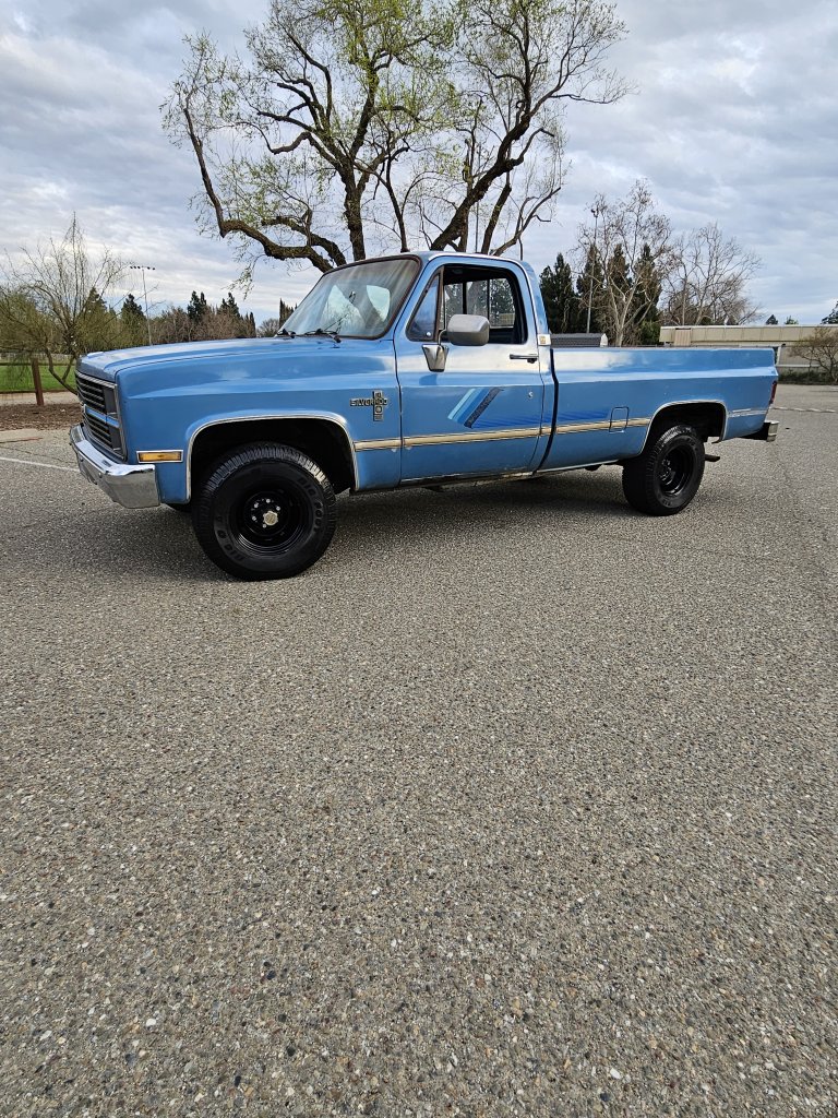

If anyone is looking for a Smog exempt square body, I have a 1984 K-10 Diesel. Never have to smog in California.
1984 Chevy K10 4X4
6.2L Diesel, No Smog In California
4 Speed Manual SM465
Perfect for a LS Swap and Never Have to Smog It!
***NO RUST, SOLID FLOORS, ROCKERS, ECT...
A/C
New drums, shoes, hardware and wheel cylinders on the rear brakes,
Bearings, pads and rotors on front
New master cylinder and distribution block
All 4 new shocks
New AC compressor, condenser and receiver/dryer with R134 conversion and pressure switch
Lift pump and fuel filter
Both fuel tanks are new with new senders,
New fuel tank switch and selector
Glow plugs replaced.
New carpet, seat cover, dash pad and headliner with sun visors,
Door hinges rebuilt
New grill and head light doors.
New radiator and fan
Rebuilt SM465 4 speed transmission with new clutch and flywheel and linkage.
**No Trades and I don't Need Help Selling.
$15,500.00 OBO
