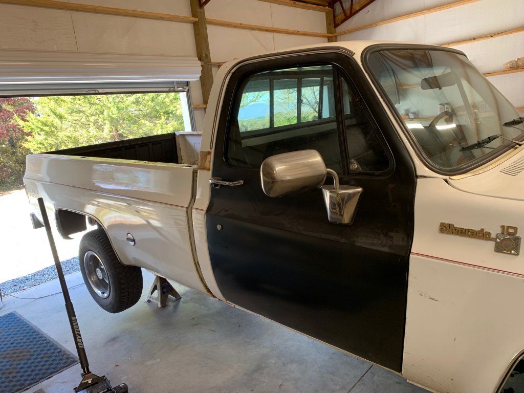

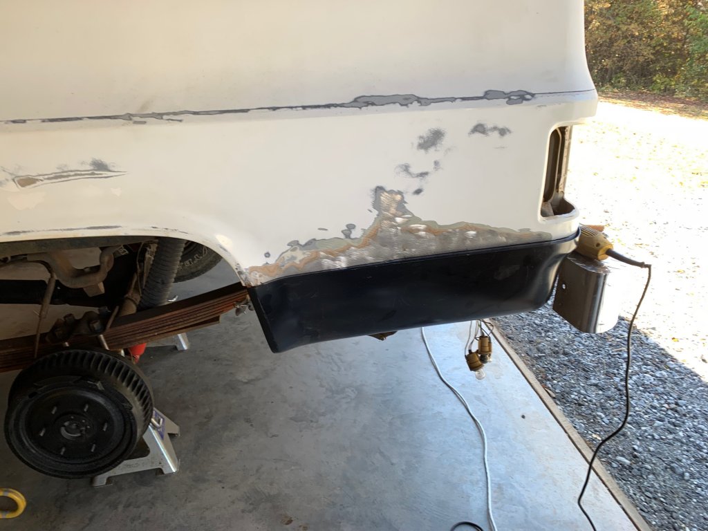

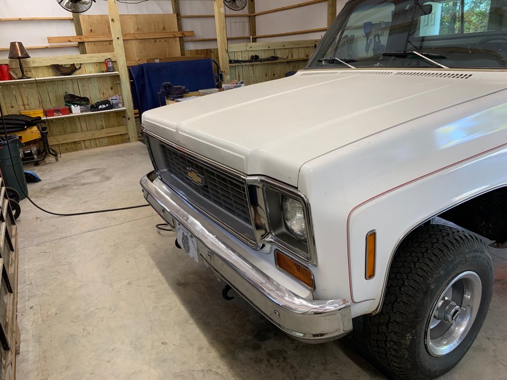

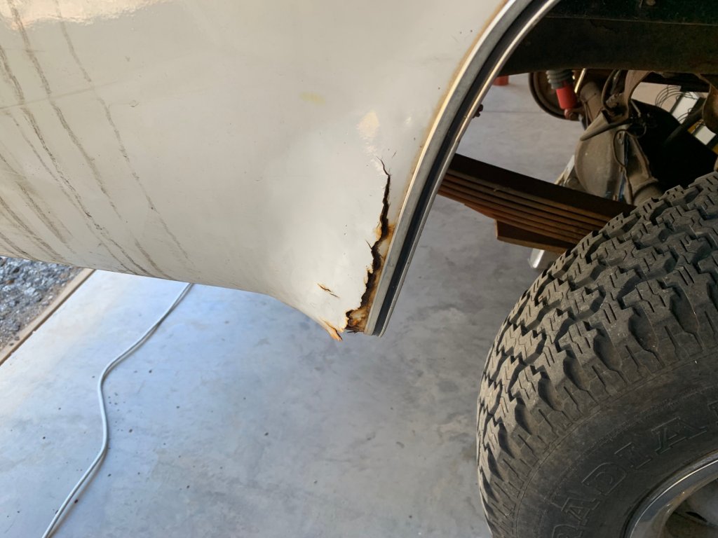

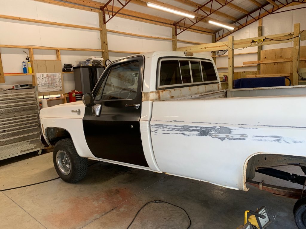

Thanks everyone, I really appreciate your input. Working on the lower bedside patch panels right now. Replaced both doors and the tailgate. Very happy with how the AMD doors fit.
