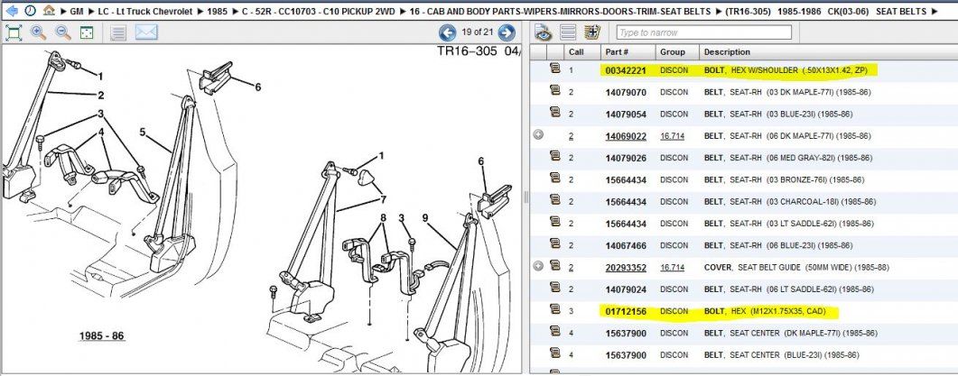

I'm not sure what you mean by "upper" seat belt.
My electronic information only goes back to 1985, but in '85 the lap bolt is an M12 (no idea if it would be in '73)
and the upper shoulder belt attachment in the B pillar is 1/2-13.

Wow thanks for that. It turns out that it was M12. I had a 1/2 and it was barely too small. M12 was just right. Weird.
