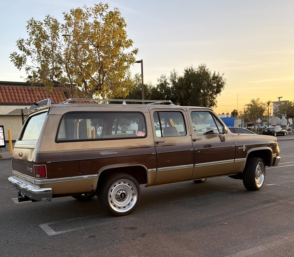

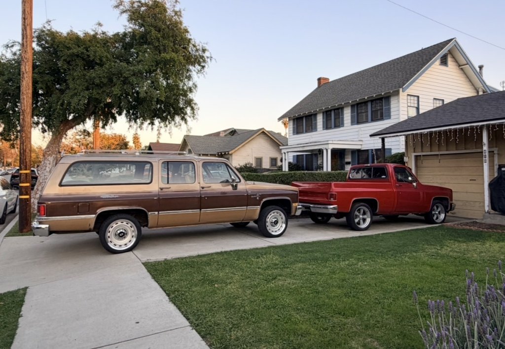

Hey all,
Have a 88 Chevy Burb 2500 Silverado trim option, 350 engine.
Runs great but recently has been shutting down on me at stops or when I excellrate after at a stop. Runs fine on the freeway. Looked up possible fixtures and so far, fuel filter change, coolant temp sensor change, iAC sensor change, and ICM sensor change.
Please share thoughts on possible issues and fix. Much appreciated!
P.S. Before you say it, yes I’m dropped it.
