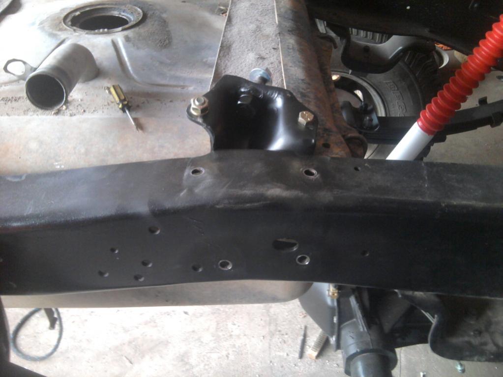

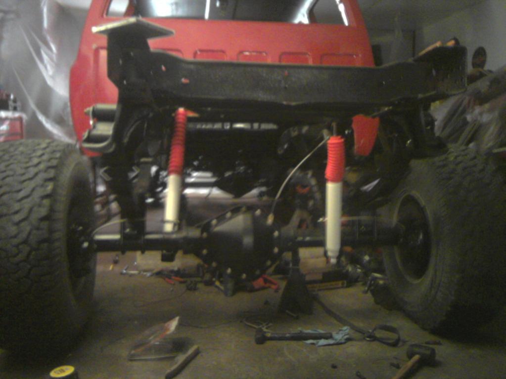

i am putting a blazer gas tank in my crew cab its a 1 ton so the shocks are on the inside of the frame.
the right shock has to be moved and my only option is to put it in front of the axle like the left shock is.
i just wonder how it will affect the ride with both in front when the shackle lets the axle move towards the rear when it flexes.
the 1 ton spring hangers are closer to the frame then 1/2 and 3/4 ton hangers so a shock will not fit between the spring and the frame.
