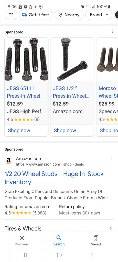

4,068
5,921
1/2 lug studs are super common. Take this pic to the parts store.
