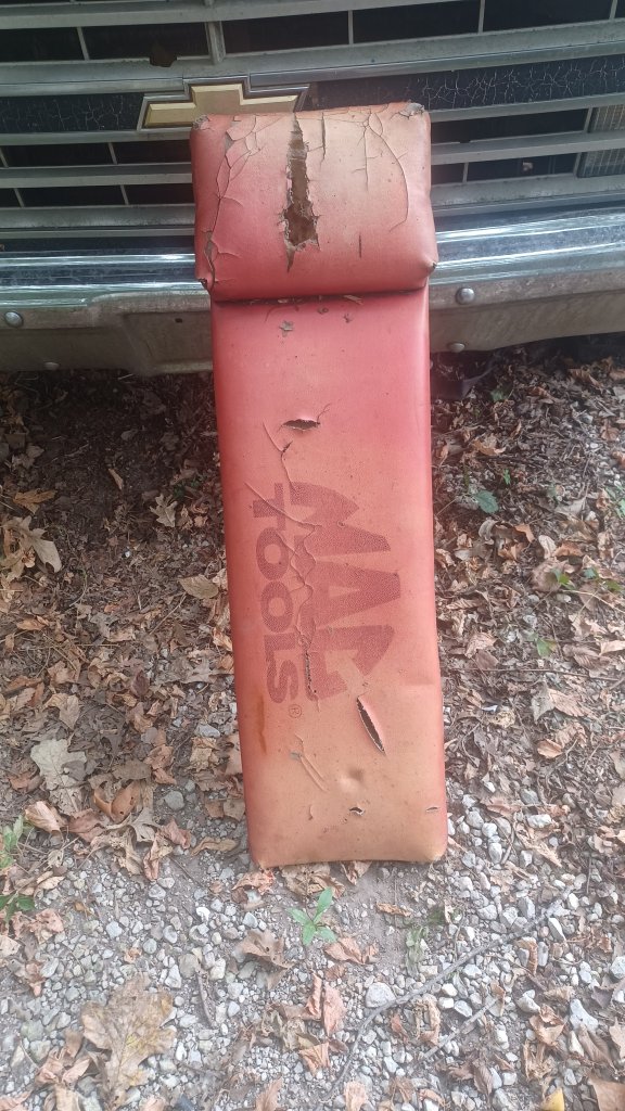

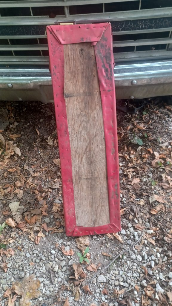

@bucket I'm usually on dirt or gravel,thus my unorthodox method and my customized dirt and gravel creeper
Before this place, I used to be on dirt, grass and gravel most of the time too. I would lay a sheet of plywood on the ground so the jack would roll on it and I'd be more comfortable too.

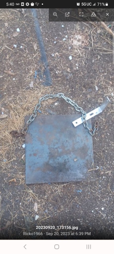

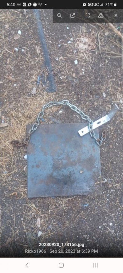

I bought that that plate with the intentions of bolting it to a floor jacknwhen I need it and using 4 l brackets and 2 chains to hold the transmission. But I've gotten too lazy. My door method works good. Actually the door method is kind of a modification of what we did at 2 different shops I worked at,both were large sturdy tables on rollers just before the finishing touches on pulling a transmission with a transfer case you roll the table under lower the lift down set the transmission/transfer case down as 1 unit on the table the lift the truck Back up did the same thing pulling Porsche 914 engines and transmissions as a unit.
