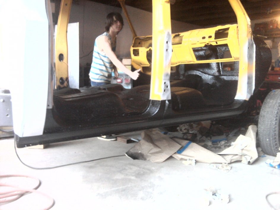

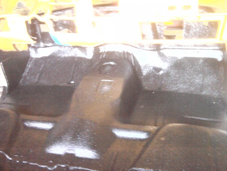

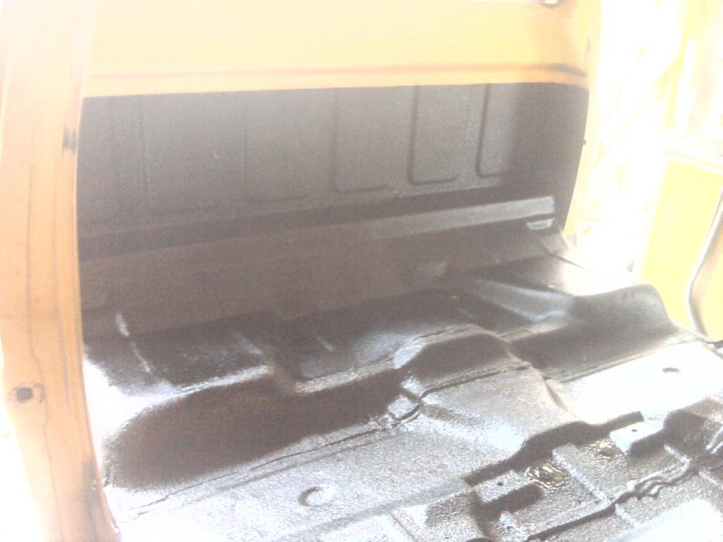

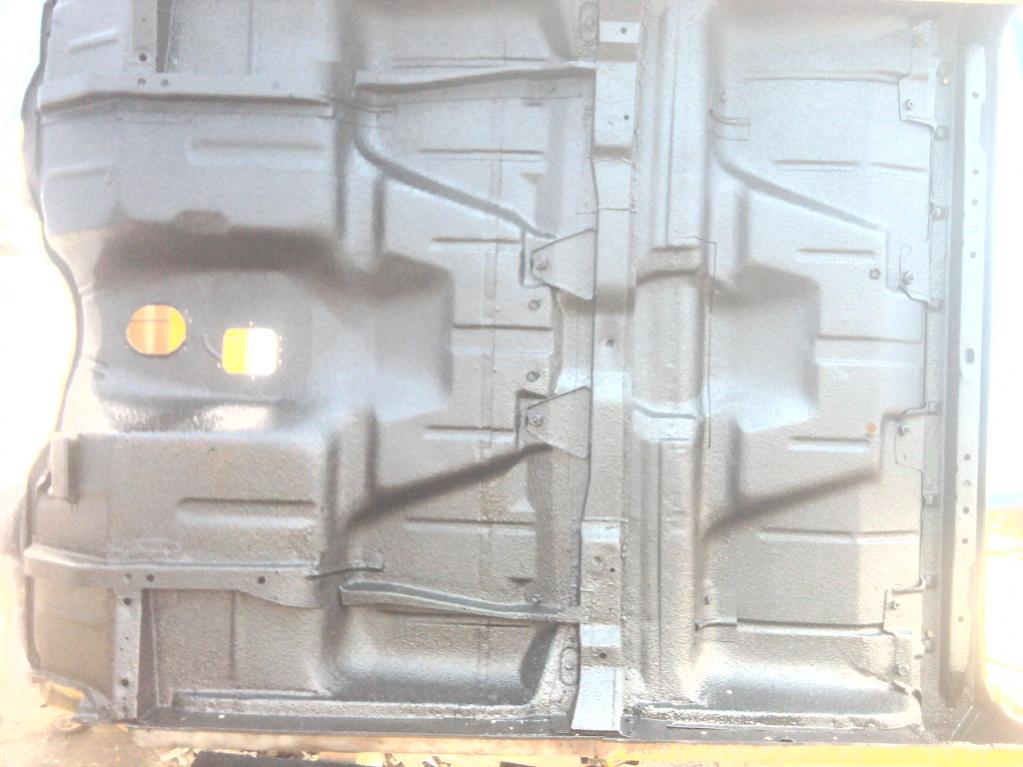

good stuff I used it as a under coat on my crew cab. its a roll on bed liner but I sprayed it with a 30 dollar under coat gun I bought of ebay.
easy to use and a good product and you can get it in many colors
