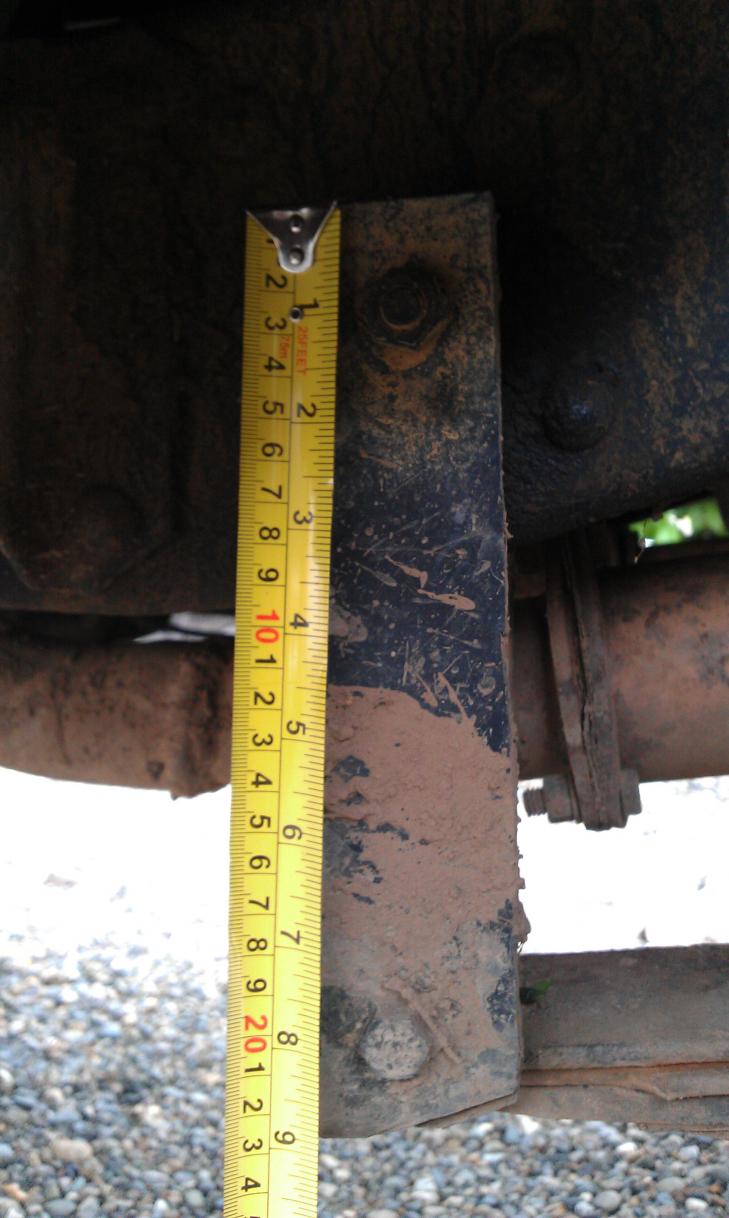

heres a picture of my shackles. from bolt to bolt there 7" long

I wish you would have gotten pics of the perches. :( But yeah, that's one honkin longggg shackle mang.

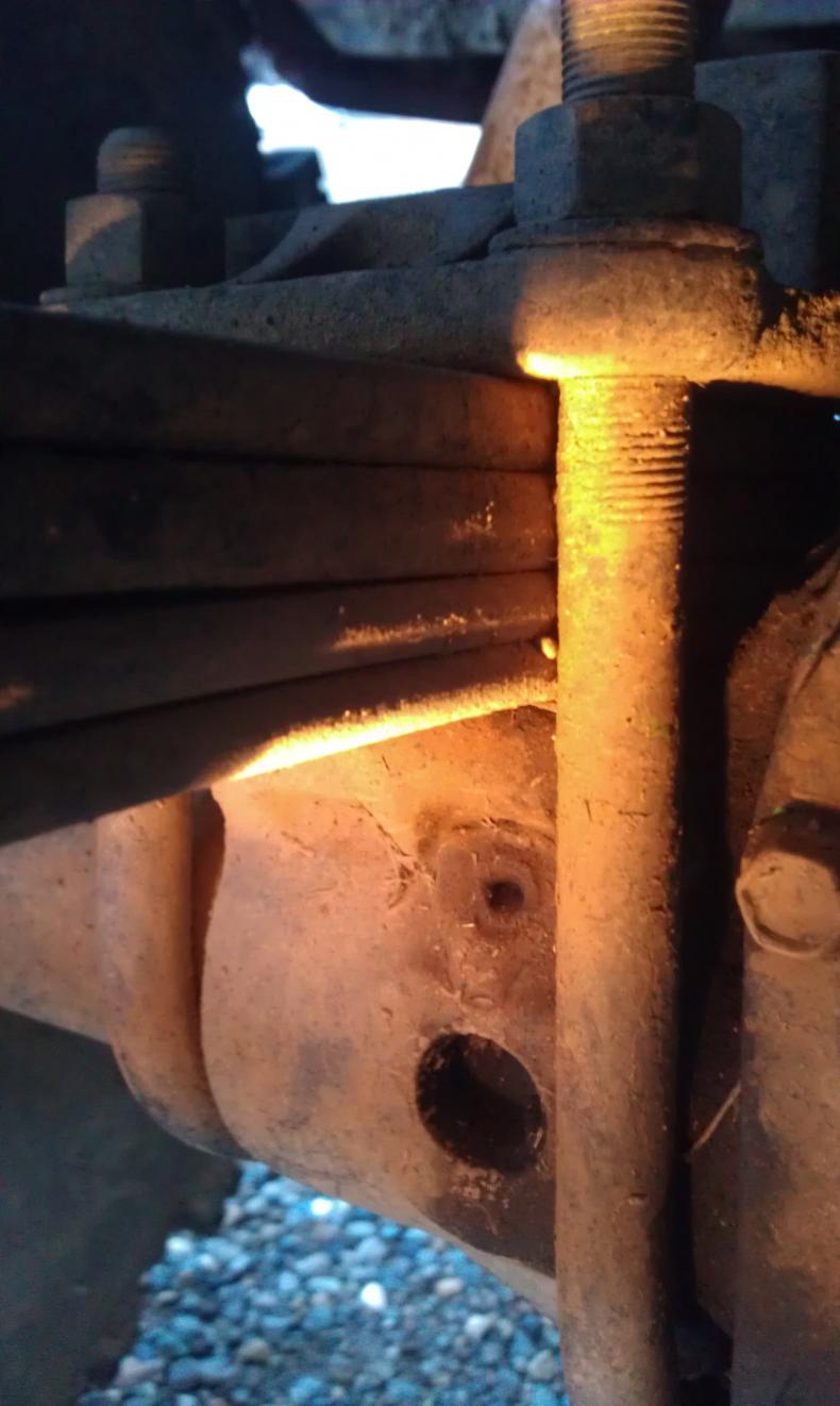

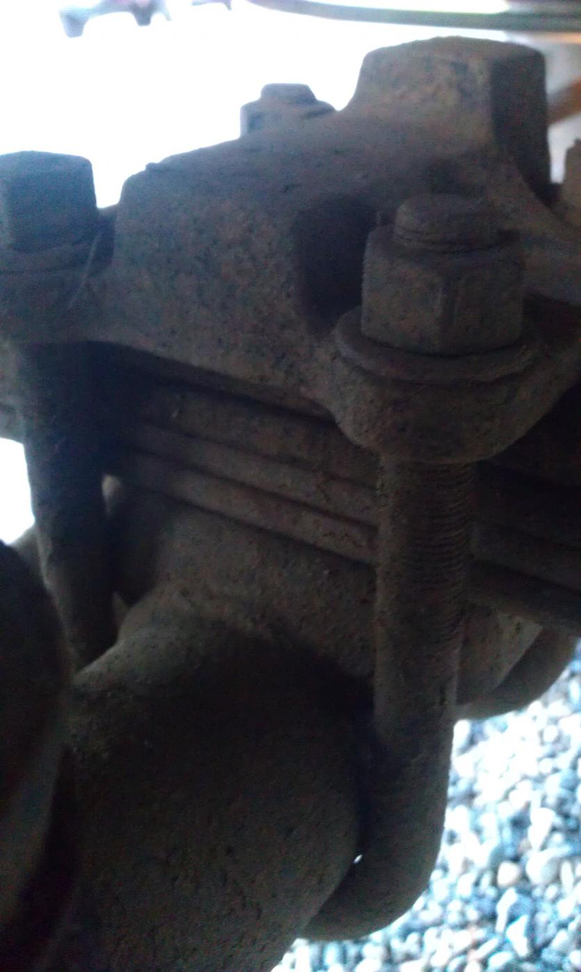

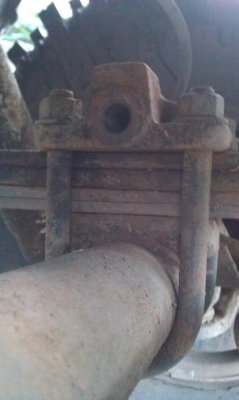

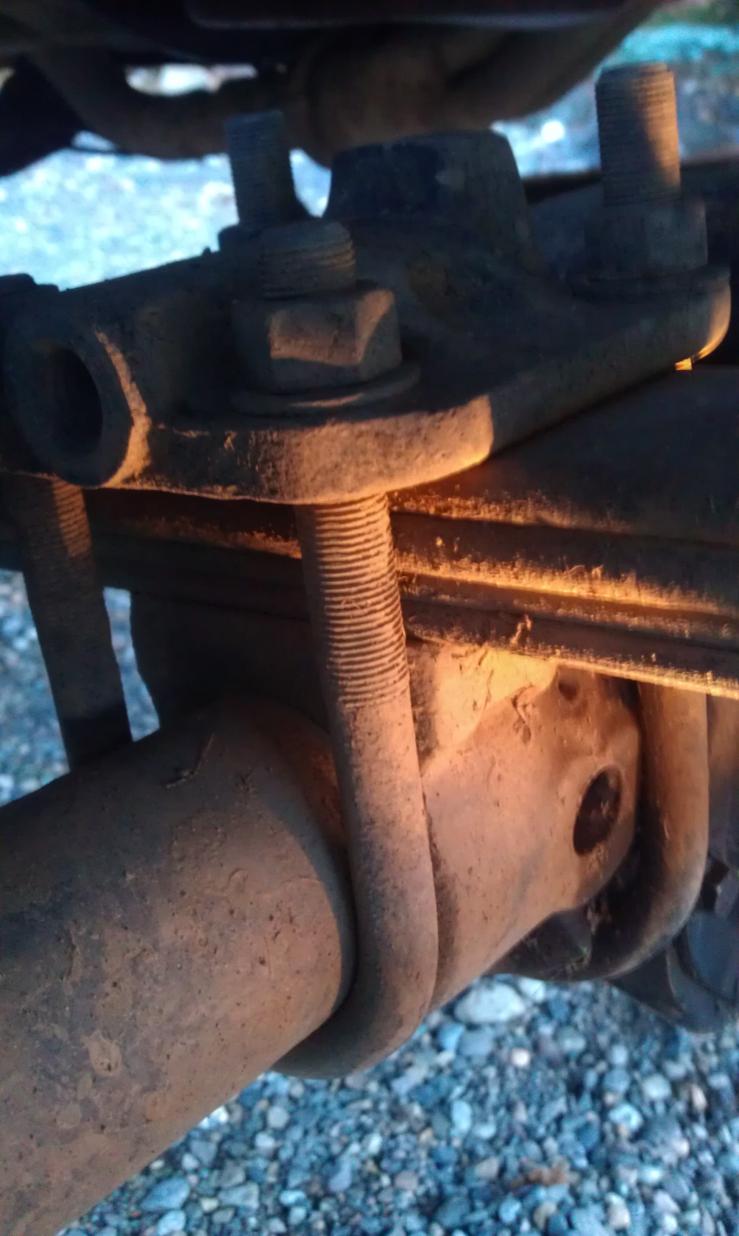

heres the perches. what specifically are you looking for with the perches though?

That looks like a factory weld to me on the driver side. The passenger side you can see the perch is actually made into the cast iron center section. So you can see welding a shim or rotating the pinion by grinding down the perch at an angle is a bad idea. Now I know this is aggrivating me wanting a pic of this and a pic of that, but see if you can get a pic of the angle the pinion is at. Be back far enough and level with the ground good enough so we can see how bad the angle is. You need some upward pointing of the pinion but not so much that the pinion bearing starves for lube. Does the truck steer funny when driving on the blacktop? Unusual tire wear? With too much shackle your caster angle changes and all kinds of weird drivability problems pop up.
